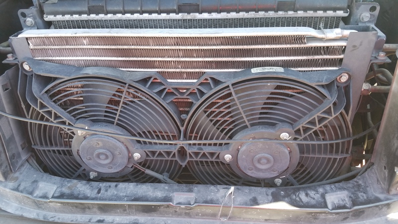

Went to the junk yard yesterday on my lunch break. I saw this 4.6 P38 sitting there. We all know they built the RR better than the Disco. Seems like they were on to something here.
Our AC driers may be in the way of this set up. I wonder if you could move the drier forward enough to get the fan under it? Interesting how much bigger the condenser is on these trucks. Also how much larger it's fins are. With a HD fan clutch and two cage style pushers...maybe that would solve the issue with the added AC temps?
I may end up wiring another fan next to the 14" Flex a lite I put in for the A/C Fan.
