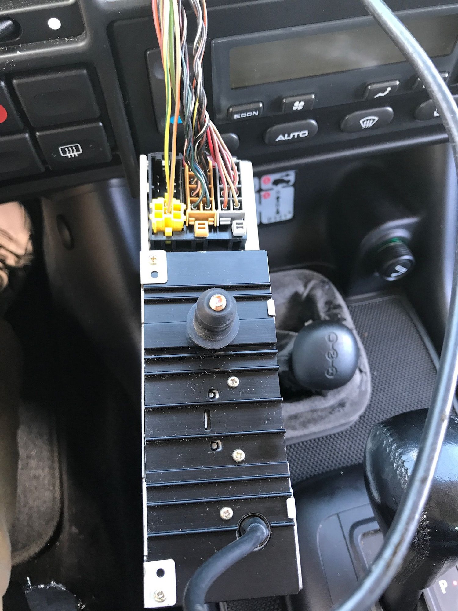

Update to this post. I picked up another used HU for the disco this past weekend. The donor truck was a 2003 HSE. The only difference that I can see between this unit and the one I posted about above, is a hole in the rear for another smaller antennae coax, which I do not have in my truck, and the "I" button on the far left side of the face plate.
So, I got it home and plugged it all in. AM/FM & WB now displaying and the radio will seek/scan and find stations. Problem is, I have no sound at all. zip, nada, nothing. The donor truck had a CD changer and I believe the amplifier was there scattered among the other bits.
Anyone know if these head units have to have an amplifier to work properly?

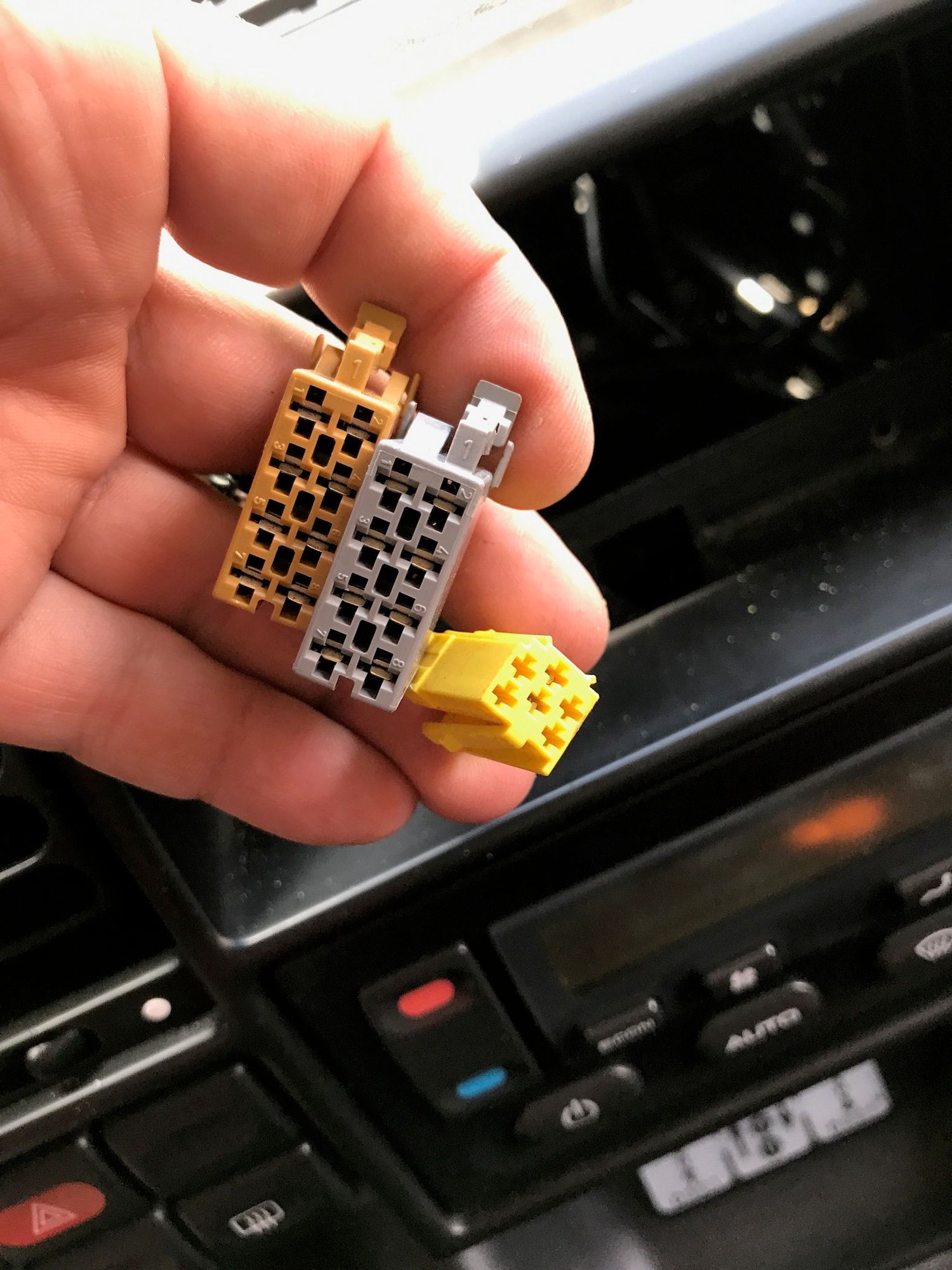

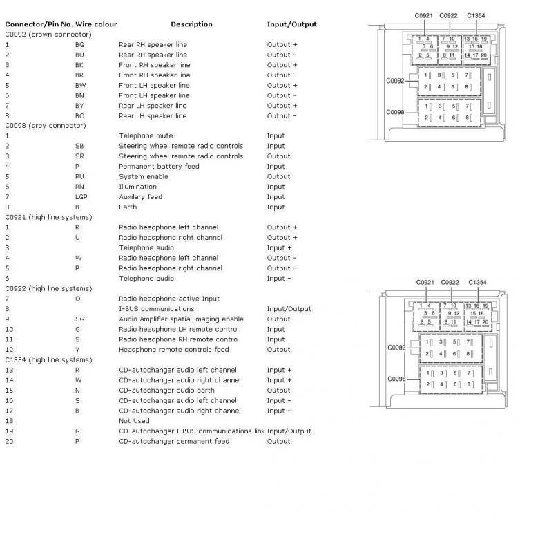

No amp under the seat, and no wiring plugs, pig tails to suggest one was there. Also, I noticed looking at the attached schematic, that one plug that I do have is for an accessory that I don't have.
In this picture I have three plugs. Connector 0092 (brown connector), C0098 ( gray connector), and C0921 ( yellow connector) and one antennae coax.
Per the schematic, the yellow conn is for radio headphone and telephone audio.
I have no connections in the second row for head phones and no telephone/ blue tooth/ hands free options.
