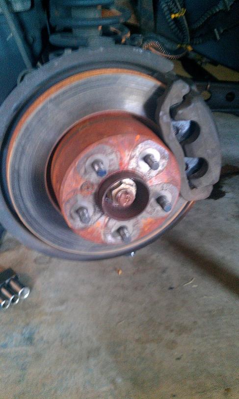

So, If anyone is interested here is how I changed the left from axle seal on the 99 DiscoII
Pic 1 Is wheel removed

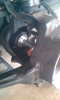

Pic2 Remove Brake disc

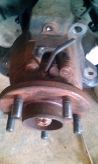

Pic 3 Remove speed sensor from exciter
Pic4 Remove 4 bolts from Hub
