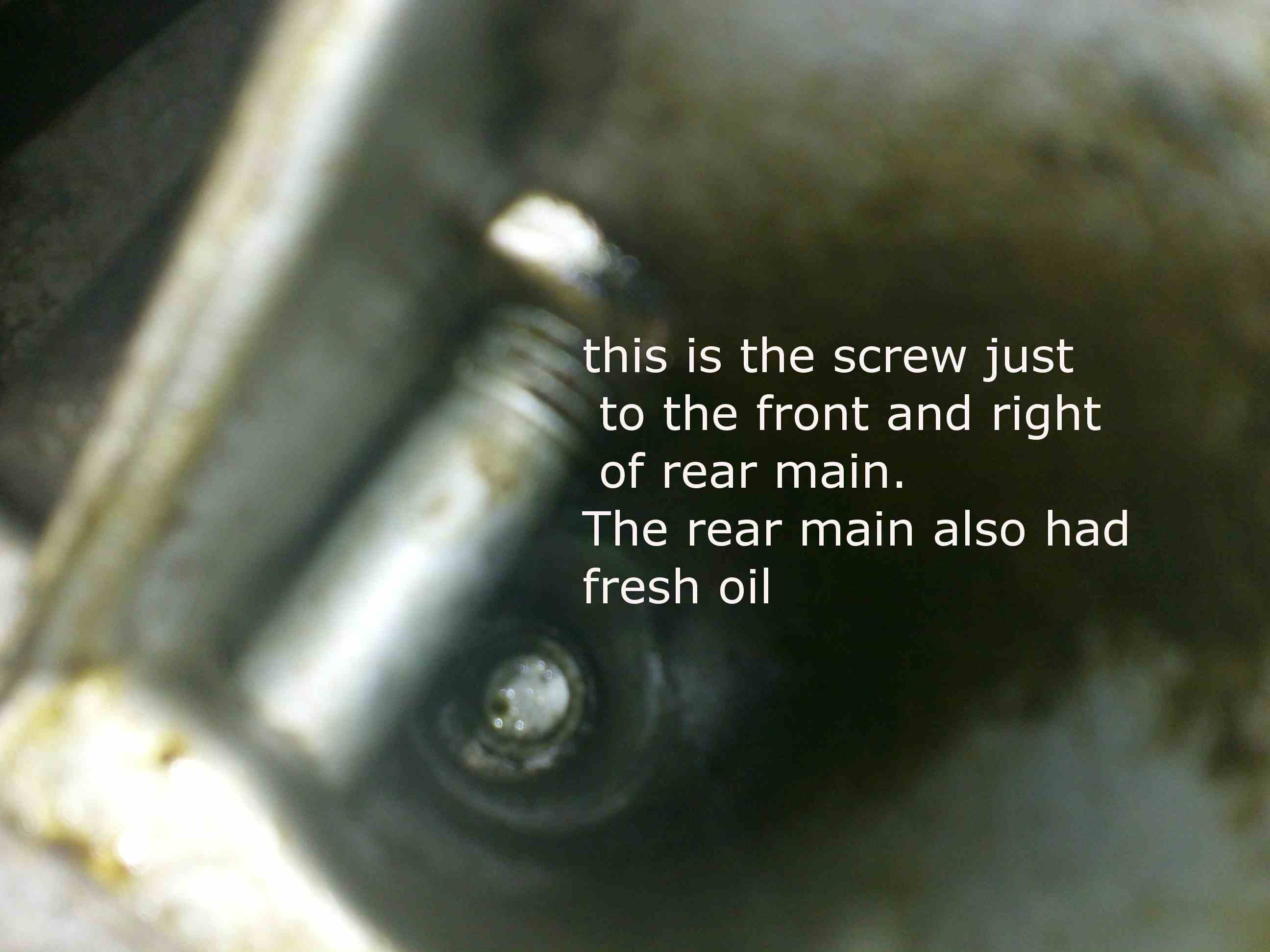

1. seapage from rear main (fresh oil) and the right hand screw just in the front of the rear main seal in a deep whole (Picture#1).

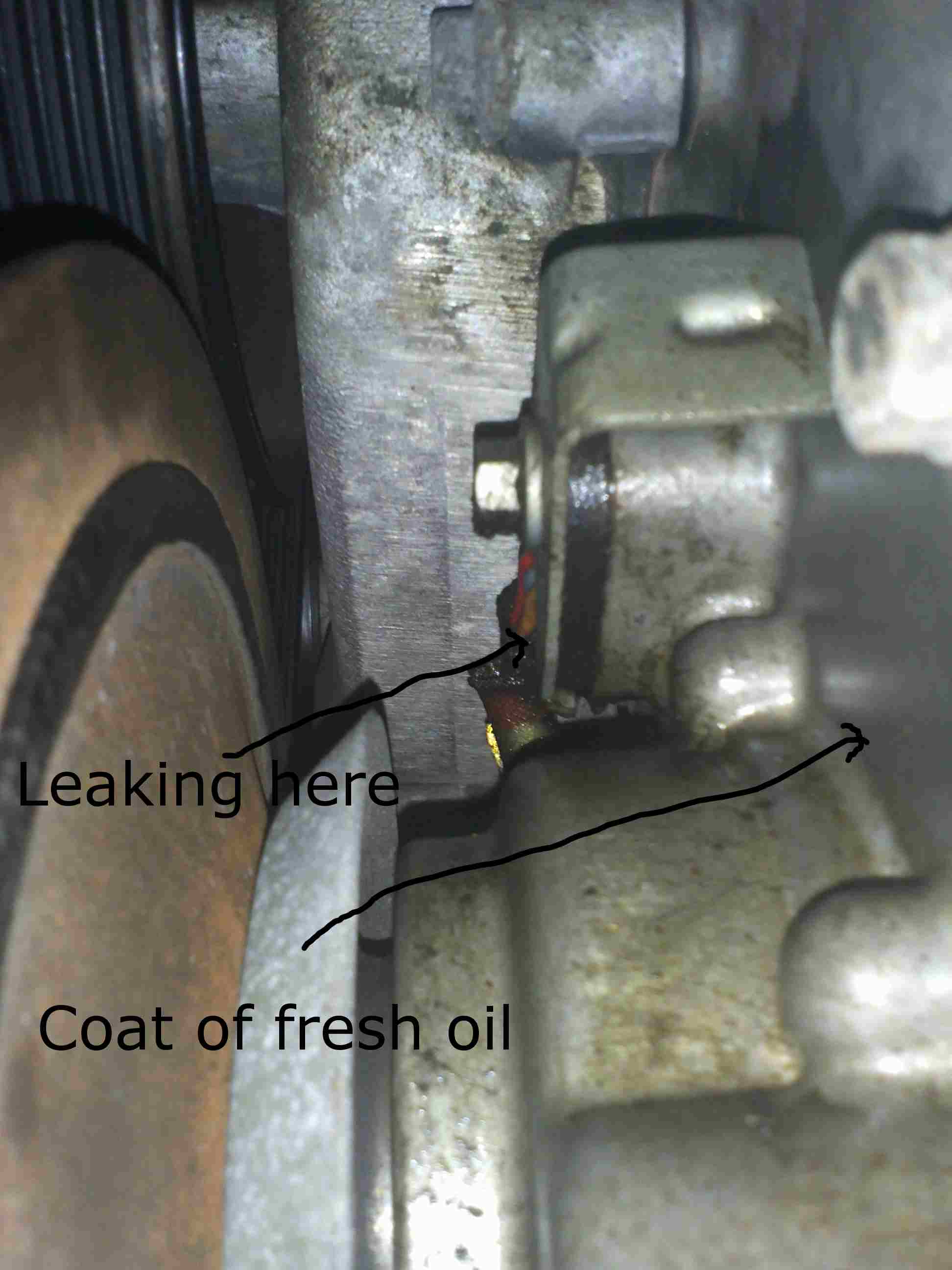

2. Fron crank seal area, probably the seal, not sure if it might be from a screw (picture#2)

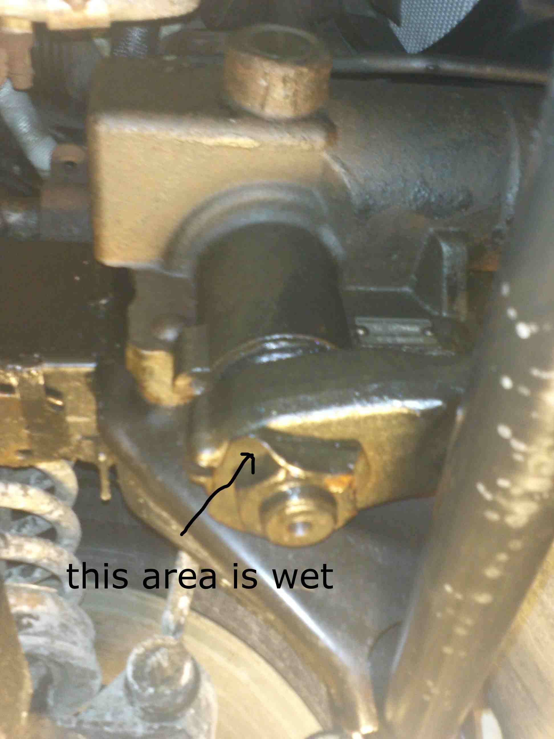

3. The area below the stearing box, where the big screw connects to the drop arm is always wet, no leak from the power steering hose, I don't know if this area can leak or if it is old fluid from my powersteering leak. I did use quite a bit of degreaser before. No dripping just wet (Pic #3)

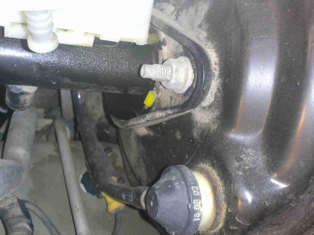

4. Below the brake reservoir likely from overfield brake reservoir after brake fluid flush (pic #4)

2. Perhaps snug up the mounting bolt on the cam shaft position sensor in the front cover.
3. Yes there is a seal in that area (bottom of steering box) that can leak, and a power steering leak stop product may slow that.
