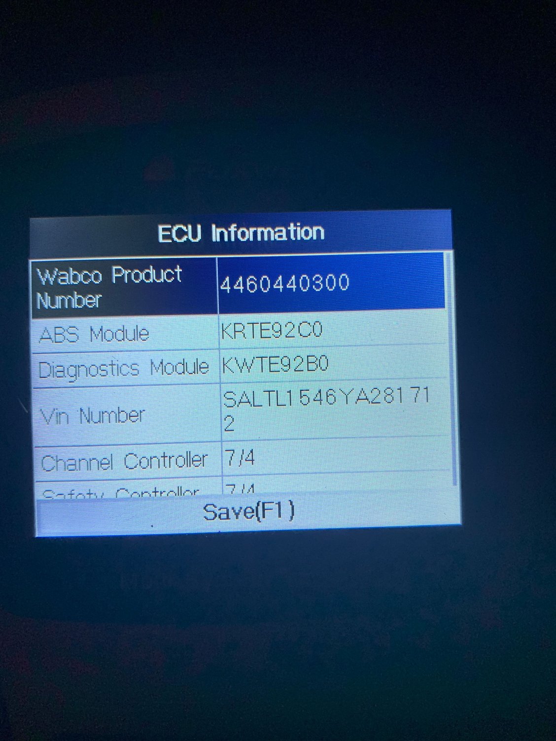

I haven’t done anything with the unit but thought that it was a possibility the previous owner did and checked it and they match my dash vin in both the engine ecu and slabs ecu screen. On some website I typed in my vin and it said it was wrong as well witch threw me off but checked another and it came up right. My only thoughts is some glitch in the foxwell software between porting it to the nt530 from the nt520

I had no luck and ended up returning it. I verified the VIN on the ECU, so it had to be a software issue. I tried updating it from the Foxwell website, which is confusing and not at all secure. When that didn’t work I contacted the seller. They said they would follow up with Foxwell, but that was the last I heard from them.
