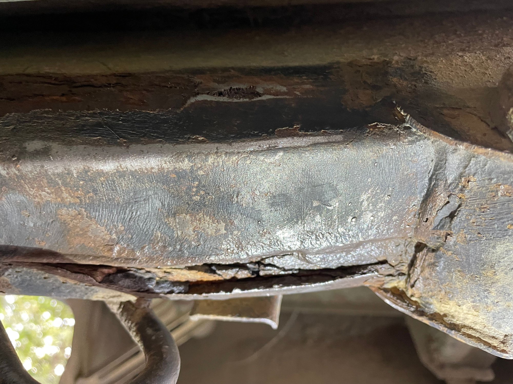

I have a bit of an issue on the passenger side rear - it is still solid but I figure get sorted while the metal is still good. My plan is to basically add a "C-channel" around the iffy bit and get it welded in place.

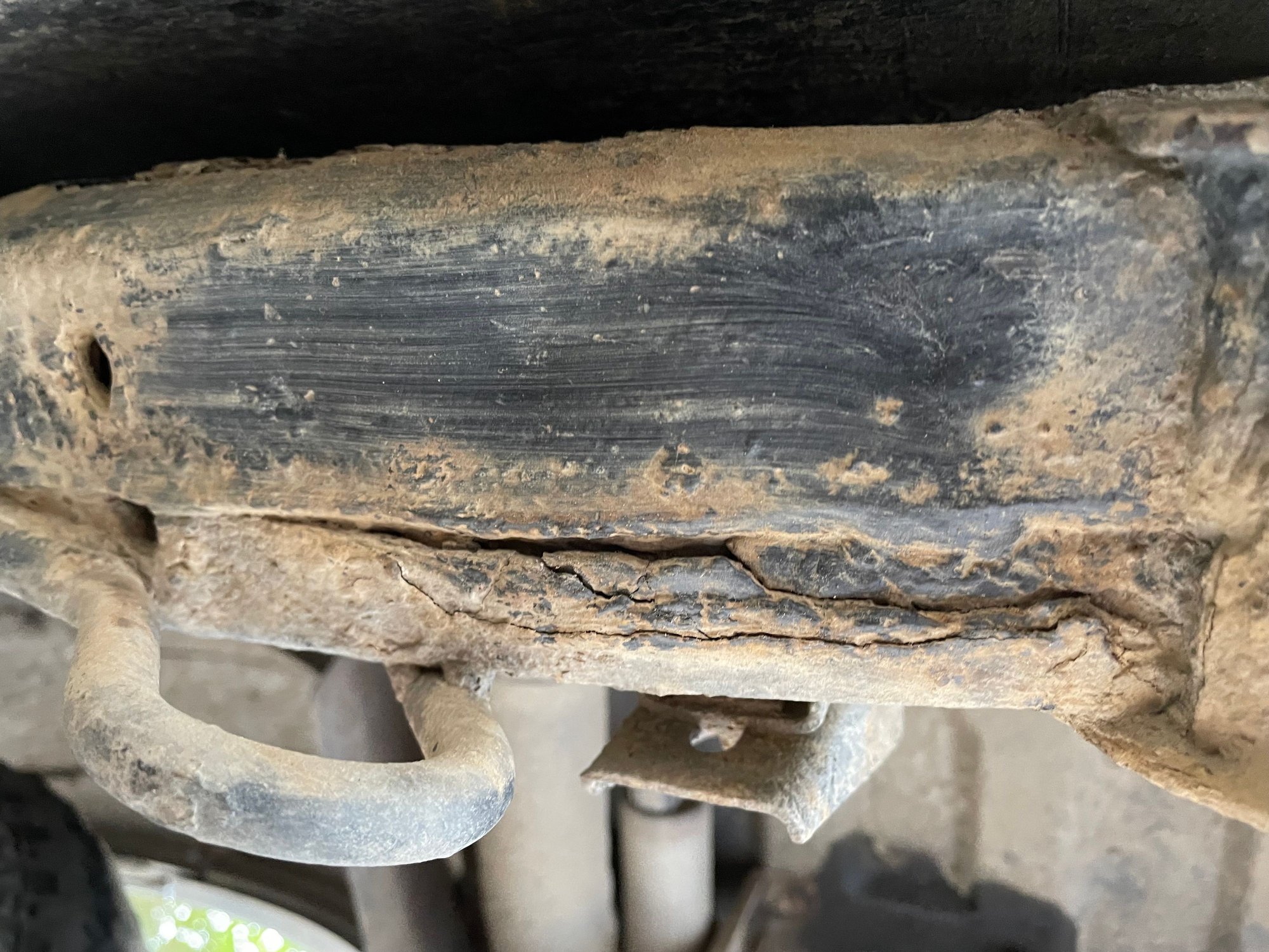

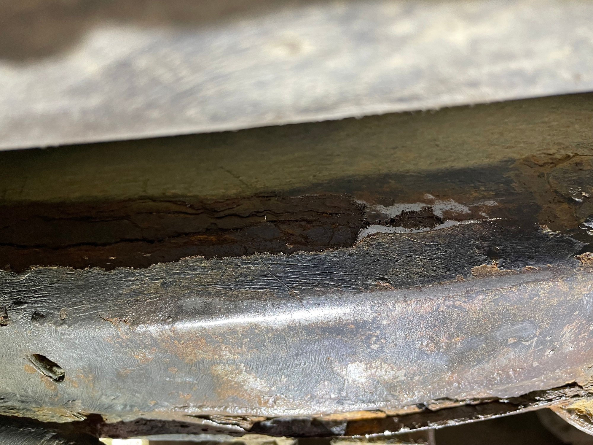

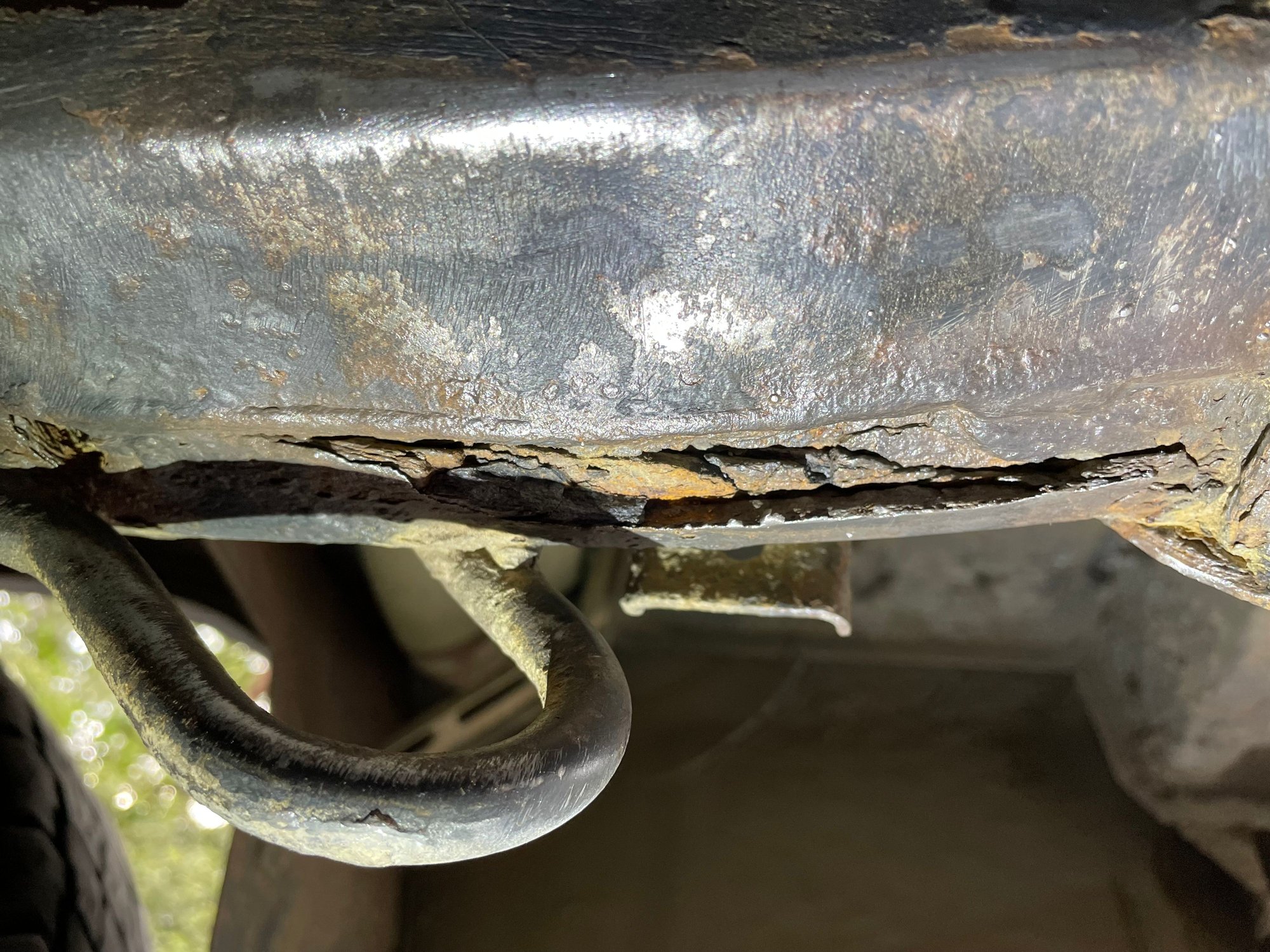

Well this got more interesting looks like a PO whacked the frame rail good and put epoxy putty in the crack then covered with a big coat of under coat rather than fixing it right.
Looks worse than it is both rust patches are about 6 inches long, not any depth to side one but the lower is a mess. Using hammer and screwdriver I found no other obvious weak spots.
My plan is to try and get it fixed without dropping the gas tank, as I can not weld so that is pay for someone to drop the tank and put it back. The lower crack can have a patch welded over, although a u shape going all the way up the sides would be ideal a patch along the bottom would suffice. I still need to do more clean up to get to bare metal to find a solid anchor for the patch.

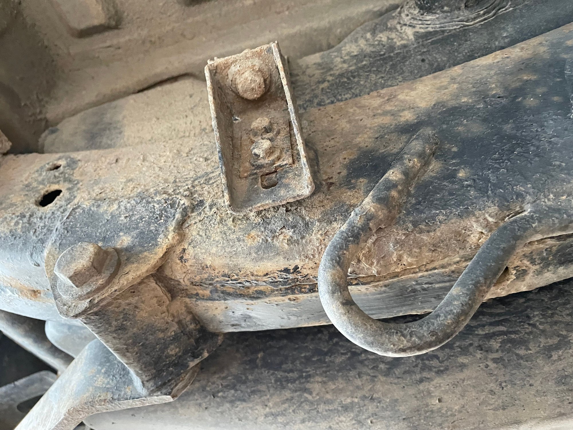

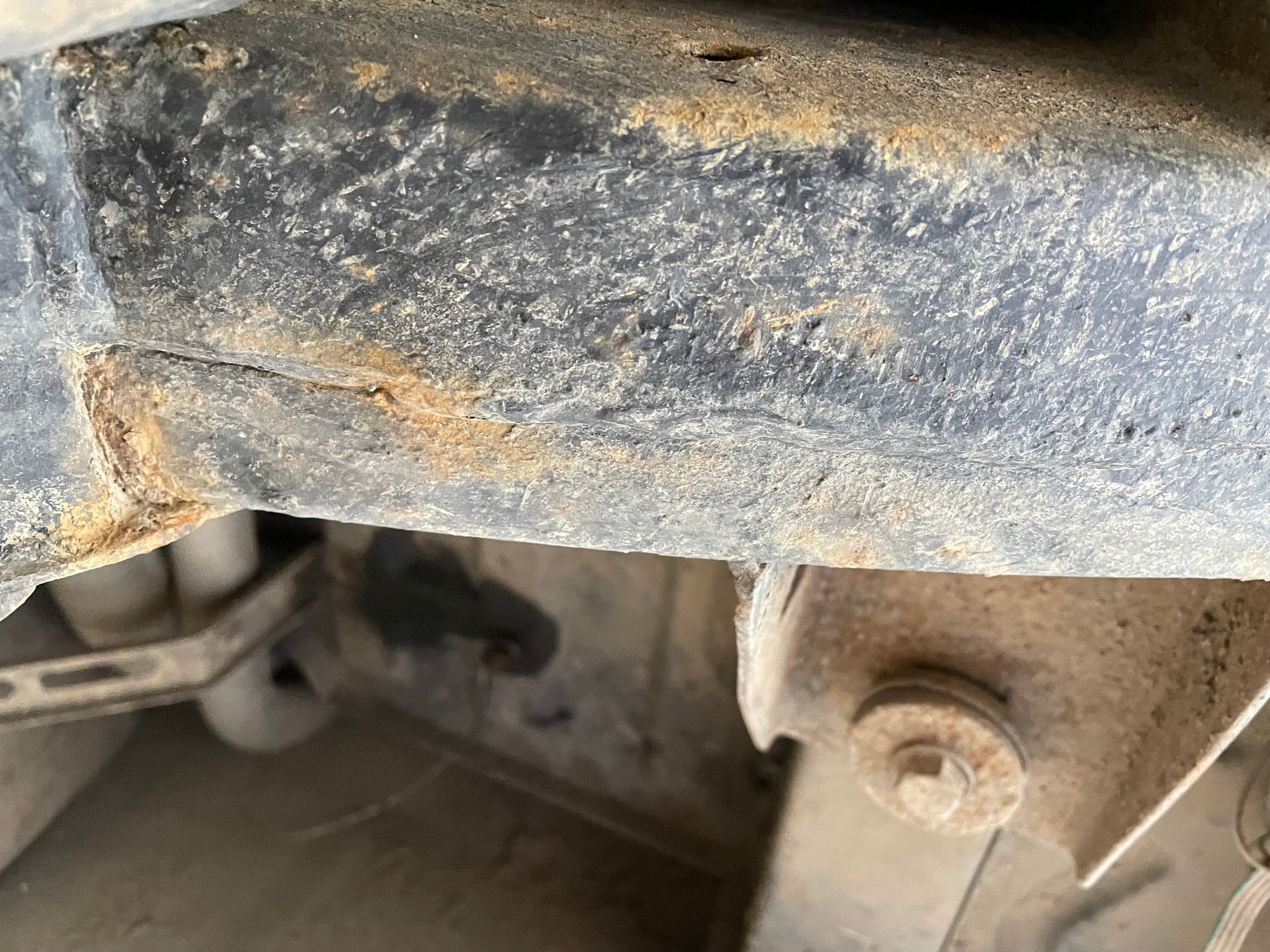

Further update on the recommendation of a UK Rover owner I whacked around with a framing hammer and nail set looking for soft spots none found. Even the bad section only dimpled in a very minor way
I then got a borescope and inspected the inside - good news other than a ton of spider webs no rust flakes lying in the bottom even when I struck the frame with a hammer and punch in the area around the scope.
The damage appears to isolated to the section in the images and only on that one side which is good.
Based on that I will most likely go with the patch kits as the frame appears to be largely intact and they will add full length additional structure.
