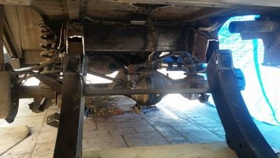

I’m definitely no expert on this but I’ll throw in my 2 bits. I would be leery of the stainless steel option. They’re not truly dissimilar metals but I suspect that the stainless would cause the base metal to continue to corrode. Of the 2 options I would get the steel kit from the UK. But with such a minimal amount of rust, why not just get a couple of pieces of plate steel cut locally?

@Harvlr Everyone I talked to wants to do a big fix, I have not really had time to fully investigate. My problem is the welding I need someone to do it, It may be a case of doing a full prep less cutting, and then getting a shop to place the welds.
One thing that was recommended is a zinc treatment to the patch and frame prior to patching.
This is new to me so learning as I go.

@H Hill The Amazon (chinese knock off) was just logistically simpler. I tend to go to worse case and work back so it appears patching may do the job just fine.
@Harvlr Sorry about the confusion it is a zinc paint rather than a zinc treatment - but I still need to talk to welder about that

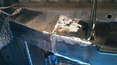

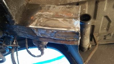

Hi again Ok I was 70 when I did mine, it took 2 days to empty my full tank, I tilted the Disco on one sire took off the filler hose drops in a plastic tube with a heavy nut on the end to make sure it was on the bottom then siphoned all the fuel out and put in a new empty 200 ltr oil drum, then remove the 3 hoses, the smallest hose that had a plastic clipped end being the most difficult but finely did it with a pair of adjustable pipe grips, level the car, remove the road wheels ,jack up as high as you can and put in stands, 4 bolt to remove the tank strap, the just pull the tank down
Next undo the 2 last body bolts, I the cut off the back cross member, before pre-cutting off the side member leaving them long for a finale trim to size, so I did it in 3 bits
When the new section arrives I test fitted it, marked the weld point on the old legs, the trimmed the old legs so I had 4in/100mm to go inside the new legs, I drilled 3 large on both sides of the new legs on the slip over bits, i
Fitted the new bit, refitted both the rear body bolt, once they were tight I clamped the new legs in place, top / both and side to side
I did need to do a small repair before I got to this point, but the actual main welding took about 1-1.5 hours a side
So it you can remove the tank prep the old legs do the drilling just leaving the welding to be done by a welder you will make a big saving, then again if you own a Discovery, it in your interest to learn how to weld and get a cheap mig welder and safe a lot of cash

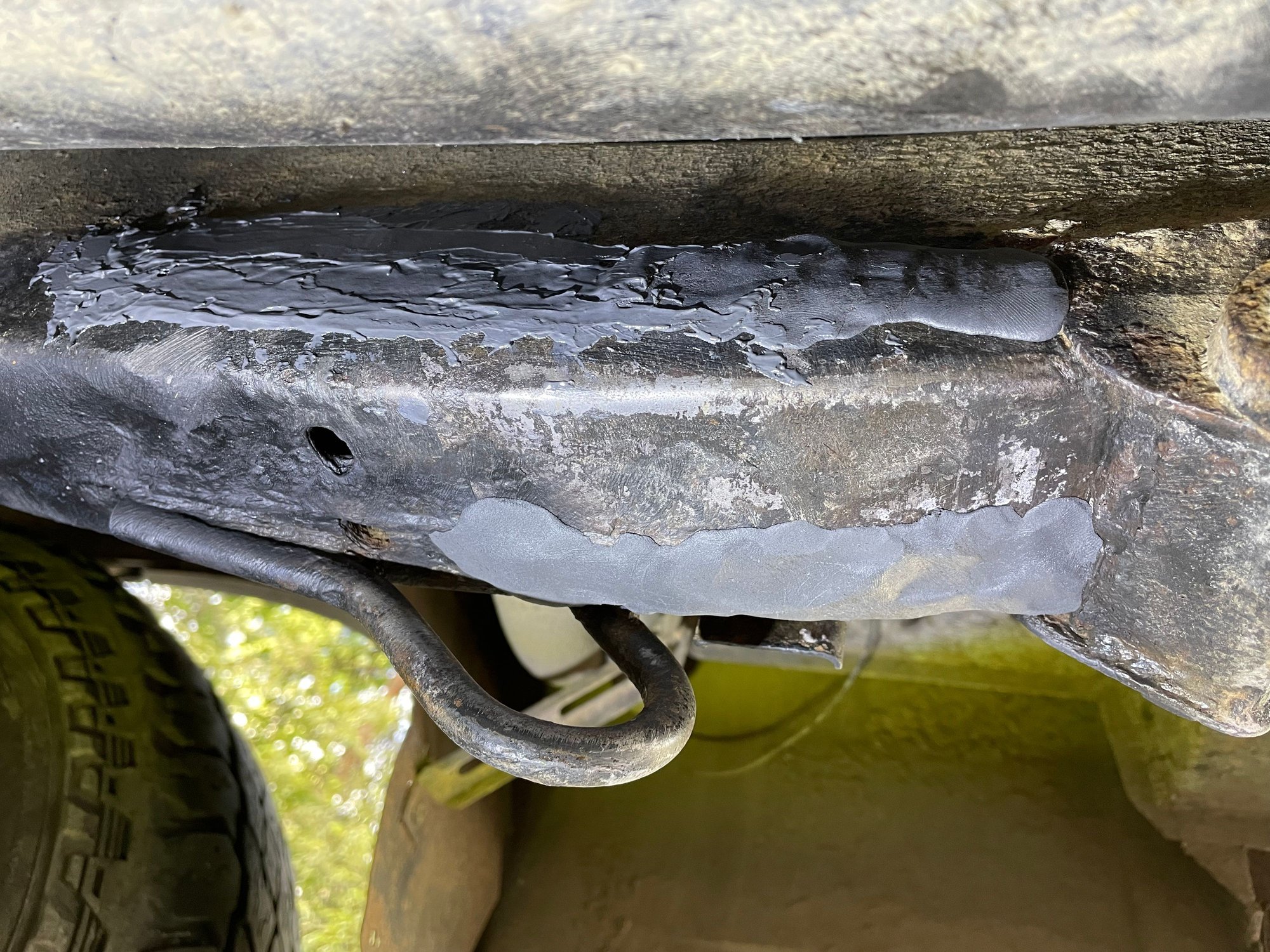

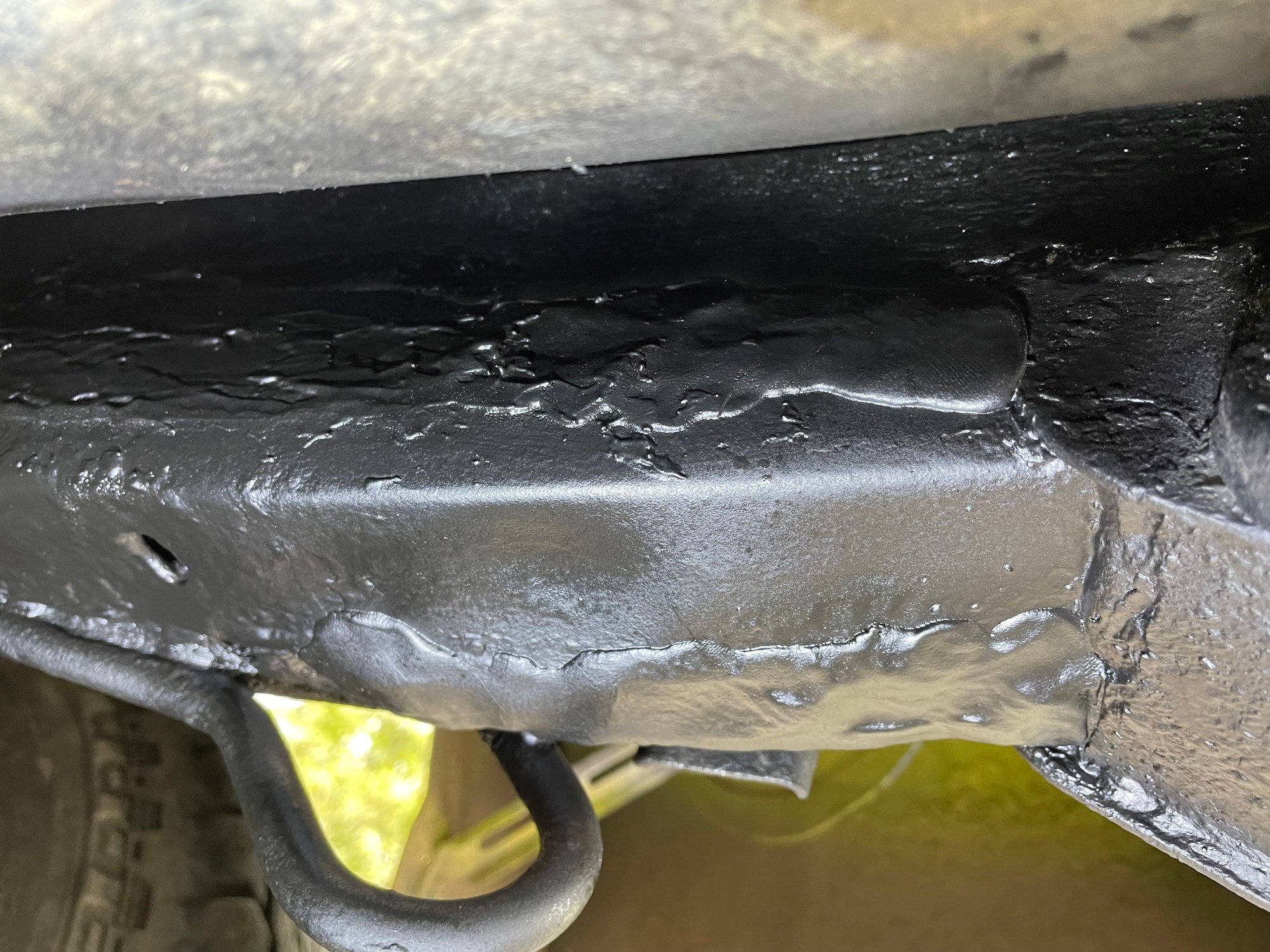

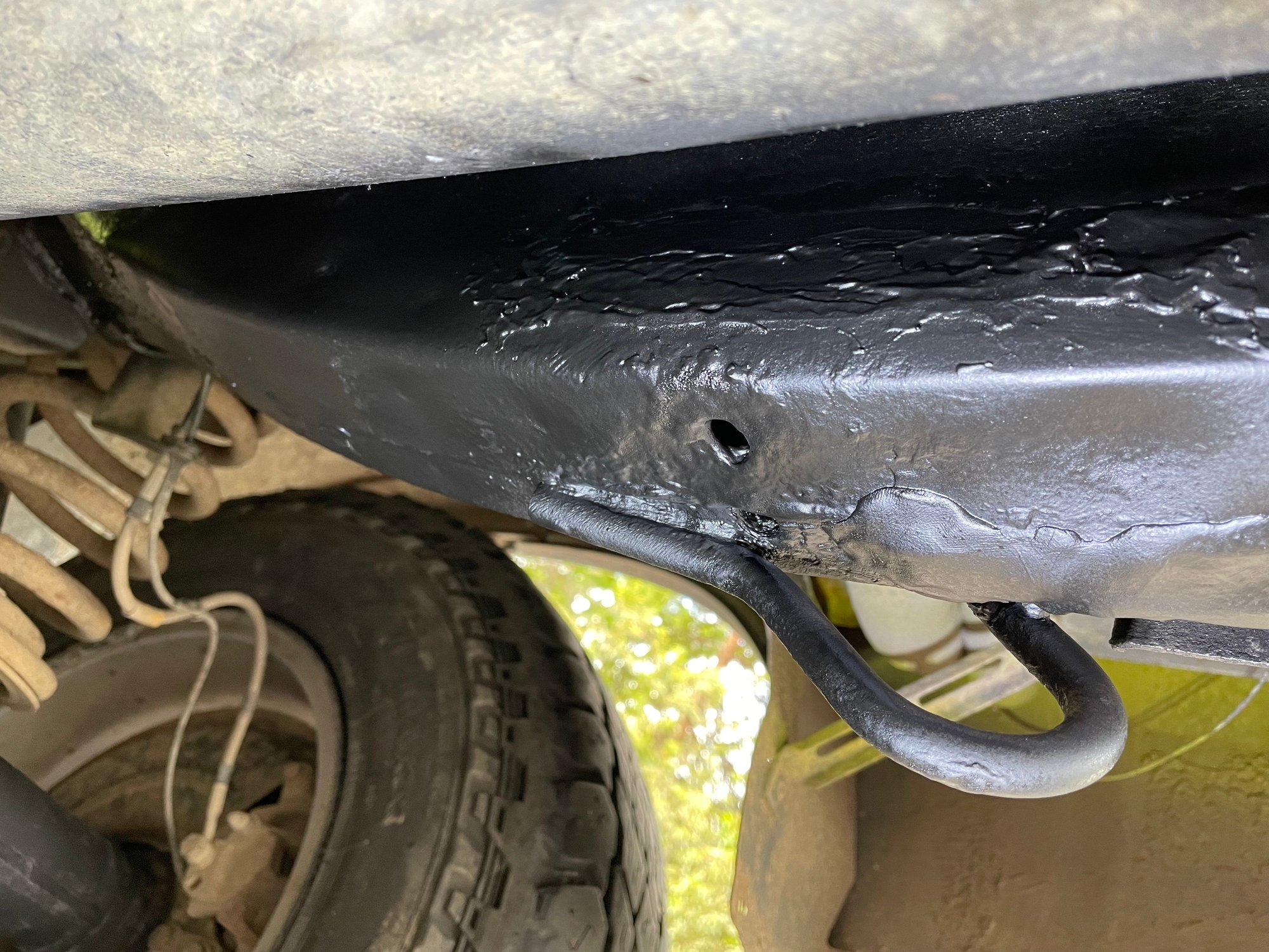

I want to stress that this is very very temporary and not a repair - it is a SHORT term stabilization nothing more.
So a wee update, after conferring with a classic car group, it is nice having a local race track. They recommend getting the rear quarter frame down to metal to get a full diagnoses of the rust issue, to determine patch, patch kit or 1/4 frame . As they pointed out it is better to do that than hope that is the only really bad spot,and they have a lot of experience as a group.
As I can not do that until spring, there are no garage space space rentals anywhere here, I decided to stabilize the damage. The biggest issue is prevent a lot of brine water getting in the frame over winter, they go a little nuts here with the brine when snow is forecast after screwing the pooch 3 years in a row.
I started with a liquid rust stabilizer and spray bottle very liberally coated the outside 3 coats and got as much inside via the various holes in the frame as I could.
Then steel stick epoxy to fill the lower gap and 2 part JB steel for the side portion that was bad, they need to be cut out prior to patching anyway followed by:
2 coats of rust paint
2 coats of black metallic I had floating around
1 coat of smooth undercoat
Yeah it will be more work in the spring but everything should stay stable until then with luck.

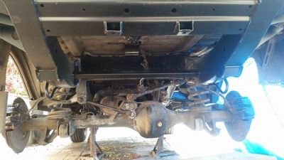

Got the axle cleaned up too
