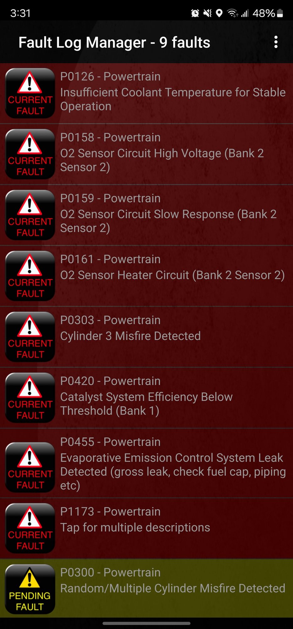

Default Codes
Here are the codes. All the 02 and powertrain codes were present before the misfire and engine noise

What are your fuel trims? That reads vacuum leak to me the evap and random misfires. I'd smoke it first or check your lines.
I agree with above to also compression test or leak down before pulling heads off if you don't find a vacuum leak.
But following KISS, I would start with what my trims tell me and see if I mis routed or cracked a vacuum line when reinstalling first. The o2 sensors could just be doing their job and telling you way too much O2.

I would go after the Coolant Temperature code first. Maybe a bad sensor or wiring open circuit. The ECU uses coolant temperature to help determine fueling, so could impact misfires and driveability.
Basically knock out the codes one by one, although folks sometimes ignore Bank 2 Sensor 2 HO2S codes if they can't afford a new sensor.
