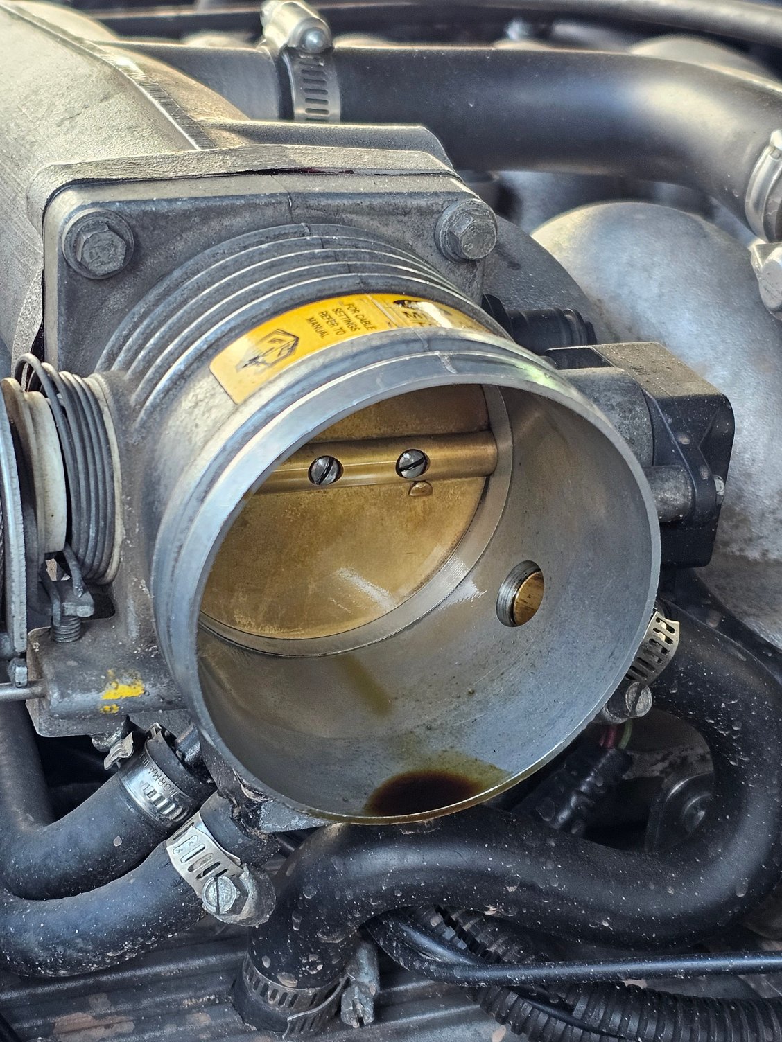

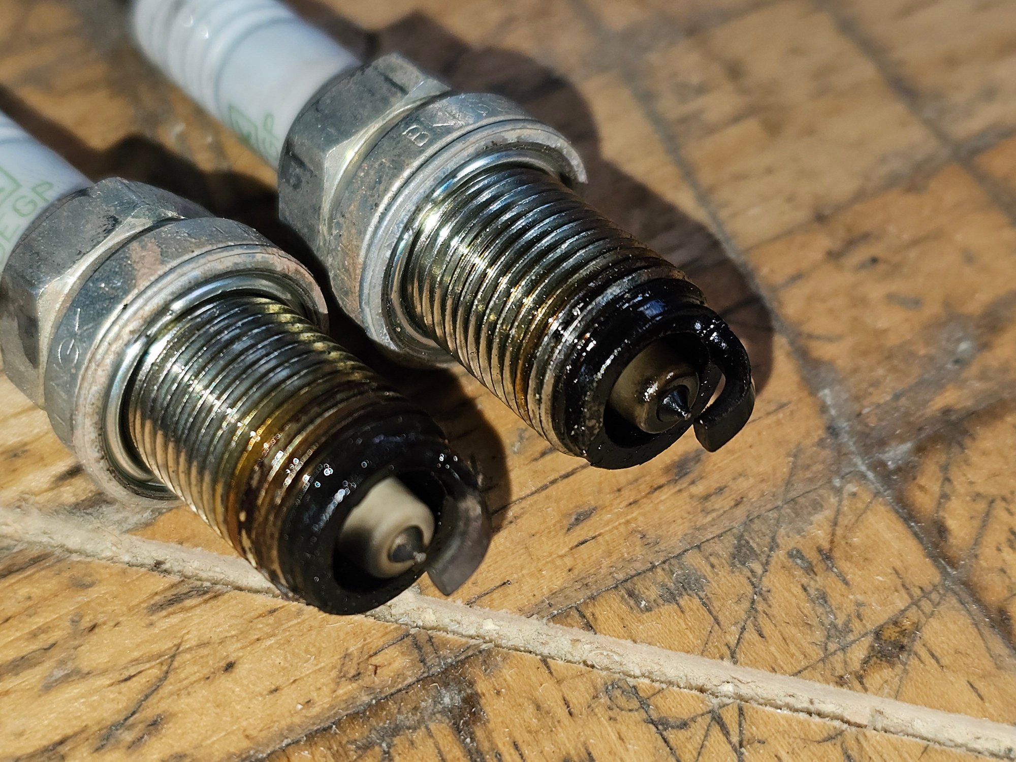

Picked up a cylinder leak down tester today. Couldn't get it to thread into cyl 3, which is my focus point.
cyl 3 plug on the right, cyl 1 on left
noticed a fair amount of oil in the throttle body as well.
I'm thinking at this point I'll just tear the heads off. Might return the leak down tester and try a different one, but it seems unlikely to me that this cylinder doesn't have low compression.

Yikes! If your labor is free keep going but otherwise I would start thinking about sourcing a different engine/block. BTW, that #3 plug looks like you are getting a lot of oil past the rings. Don't suppose you have a borescope?

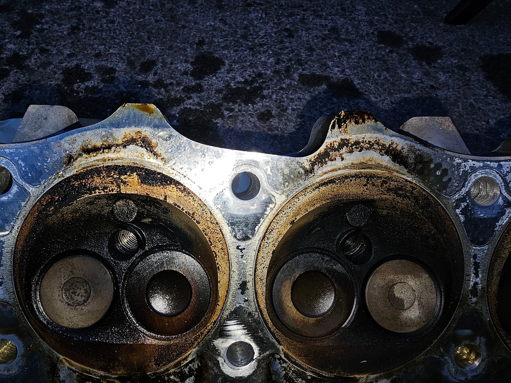

Alrighty folks. Got the left side head off today.
Cyl 3 and 5 blew out the side towards the middle of the motor
Here's the block surface
And the heads.
Any thoughts on this?

Very rare blow point, my guess is the head is not flat. Check that first.

Heads were redone at a local shop, but yeah, definitely will get them checked again. I'm guessing this is an issue with the block deck / my time serts install. Would be great if it was just the heads though.

Yeah your Timeserts are proud of the block. EZ out them and redo. Set them lower than the deck height.

Forgot to mention these are BIG SERTs, so not much aluminum to work with in the block. Holes had been previously helicoiled and previous owner pulled out the coils somehow. I'd rather not have to do any more drilling/tapping, I don't think this block is up for it. I think my best bet is to file down any that protrude. I did use a straight edge and they were flush. But worth another look.
