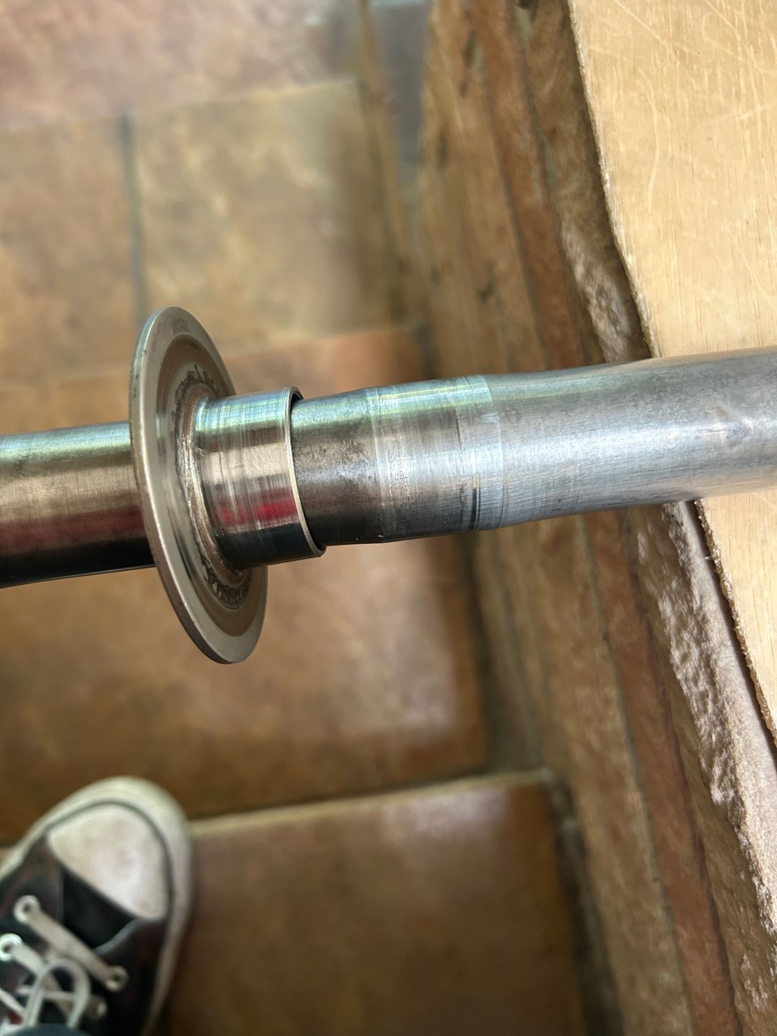

Have you checked breather hoses? Also do you have stock or upgraded axle shafts? I had an oil leak because the collar on the axle shaft had come off its lip, creating a large gap allowing fluid to literally pour out.
