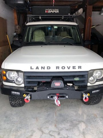

Did you have to trim the grill to get the winch to fit?

Did you have to trim the grill to get the winch, wires and control box to fit?

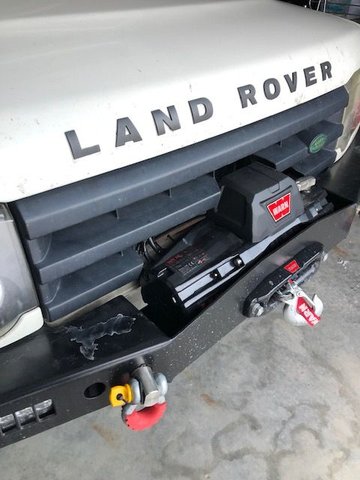

I had to trim my grill to fit the Warn winch. The winch control box can be removed and relocated but I just left it as it was and trimmed the grill. Rovers North bumper.

And with this Rovers North bumper, I was able to retain the headlight washers (slots were cut in the bumper) and it came with the slimline LED fog lights, so I was to reuse the wiring/switch from the OEM fog lights. I did not relocate the windshield washer bottle. I used some of the wheel well black plastic lining to cover up the bottom of the reservoir, protecting it somewhat.

I have the Britpart version. I did have to trim the grill slightly for my winch (not the controls or wires however) but I think trimming is specific to the brand of which you use.
Edit: I wish I had gotten one with foglight provisions. I also painted the washer bottle. I used that spray stuff you see on TV that supposed to seal anything. Flex seal or whatever. It's pretty thik.
