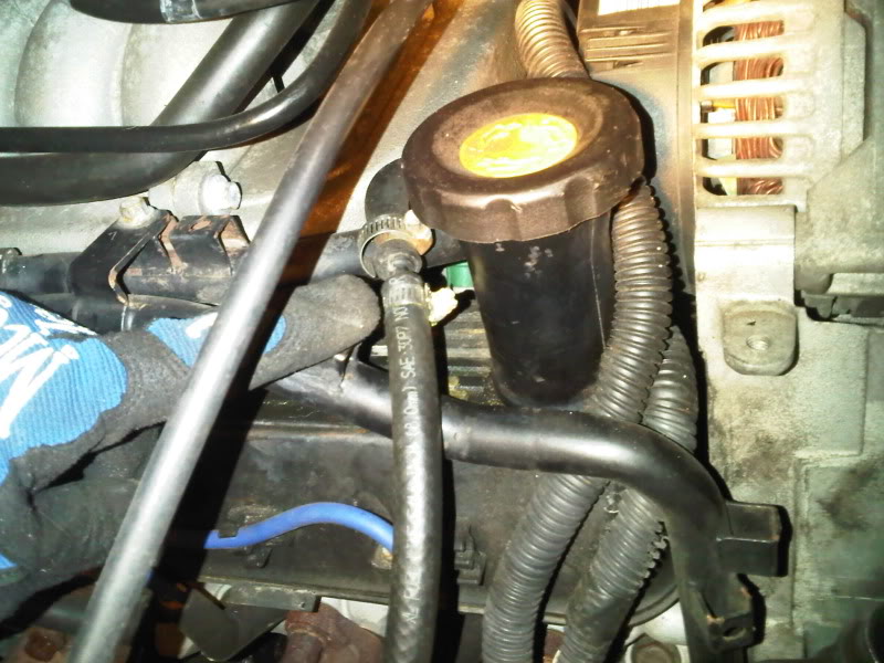

And also note on number 6 that it may have been routed different if the throttle body heater was leaking. My TBH was bypassed, so where number 6 meets the engine goes over to the coolant reservoir. On mine, it was leaking where it met the engine and also at a hose connector they put in when they moved the hose to extend it and go towards the bottle. Seriously, my leak was exactly the same a real PITA to find the way it ran down.
Here is the connector from a while ago:

I would also suggest bypassing the throttle body to at least try and isolate it. The picture I posted of the hose is what you have to do. Take the one that goes from the throttle body to the engine and run that from the engine to the overflow tank. You will then totally bypass the throttle body and possibly isolate your leak.
