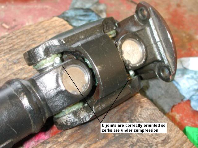

Here's pix of the part where the extra fitting are usually missing from the factory on the front shaft. You can rebuild it, have it rebuilt, or buy a new one. If you just have a patio and a couple of hammers it may be time to farm this job out.

You should have 1 per u-joint (3 front, 1 rear) and 1 for each slip joint (1 per shaft)...so that's 6 total unless I forgot one somewhere.
