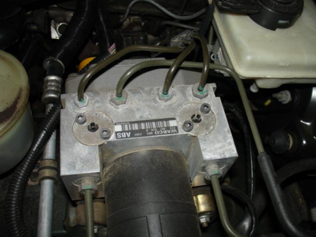

Do you know where the ABS module is under the hood? Should be on the driver side by the shock tower. If you look at the top of it, do you see a barcode?

Here are the barcodes:
SRB-101241-01-007339
478-407-020-0
003-2001
007339
Old Jun 7, 2009 | 06:33 PM
gilder's Avatar
Joined: Sep 2008
Posts: 180
From: Jackson MS
Well, if you have barcodes on it, you have the "correct" abs module. Not sure what else it could be unless the cable needs to be replaced. Need someone younger and brighter in on this one....
