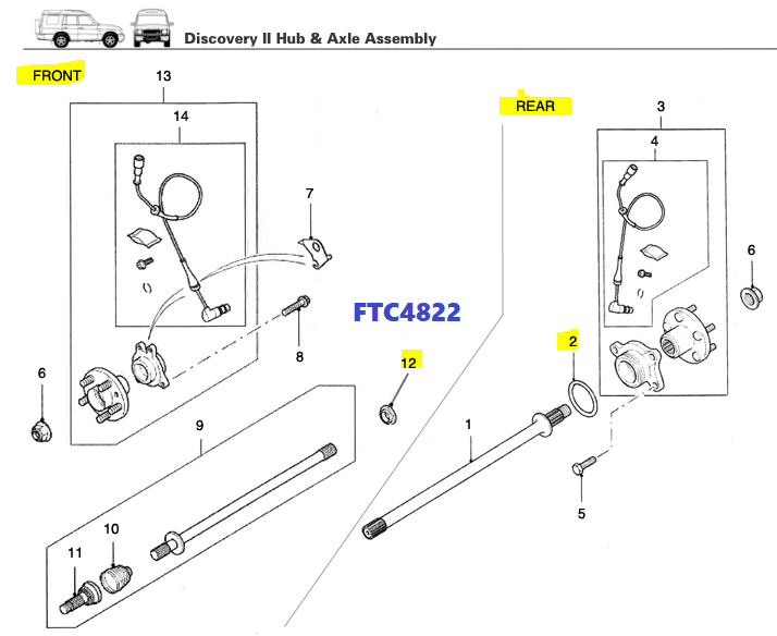

Right, ordered new bearings last night -- yay
Also need new axle nuts and o rings along with a 1 1/14 socket?
Questions:
Rear hub o ring is the same as front, jah? AB Rear Hub O Ring
Axle nuts -- $10 each?! Or are Britpart bits ok? AB Axle Nut
Torque spec is 250-360 in rave / bulletin but which is correct?

Front O ring is different size

Front hubs don't use o-rings...they have seals within the axle housing. Most hubs contain new nuts.

No O ring in the front, a SEAL is used FTC4822. See video for install.
The Hub/Axle Nut (CDU1534L) is 32mm & IMHO forget $hitPart.
360 lbf.ft is spec. Good Luck with that.
yeah, I was wrong
