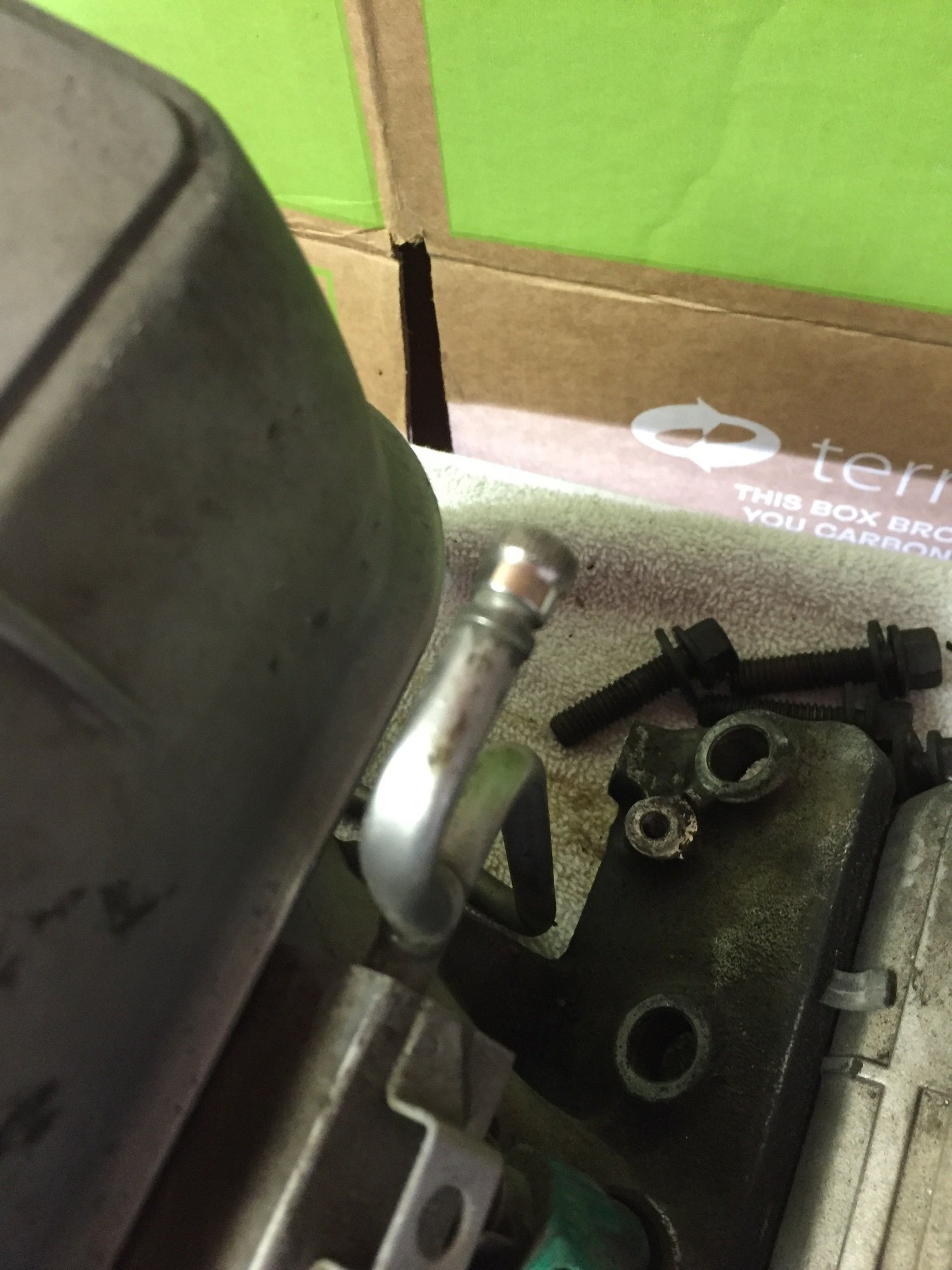

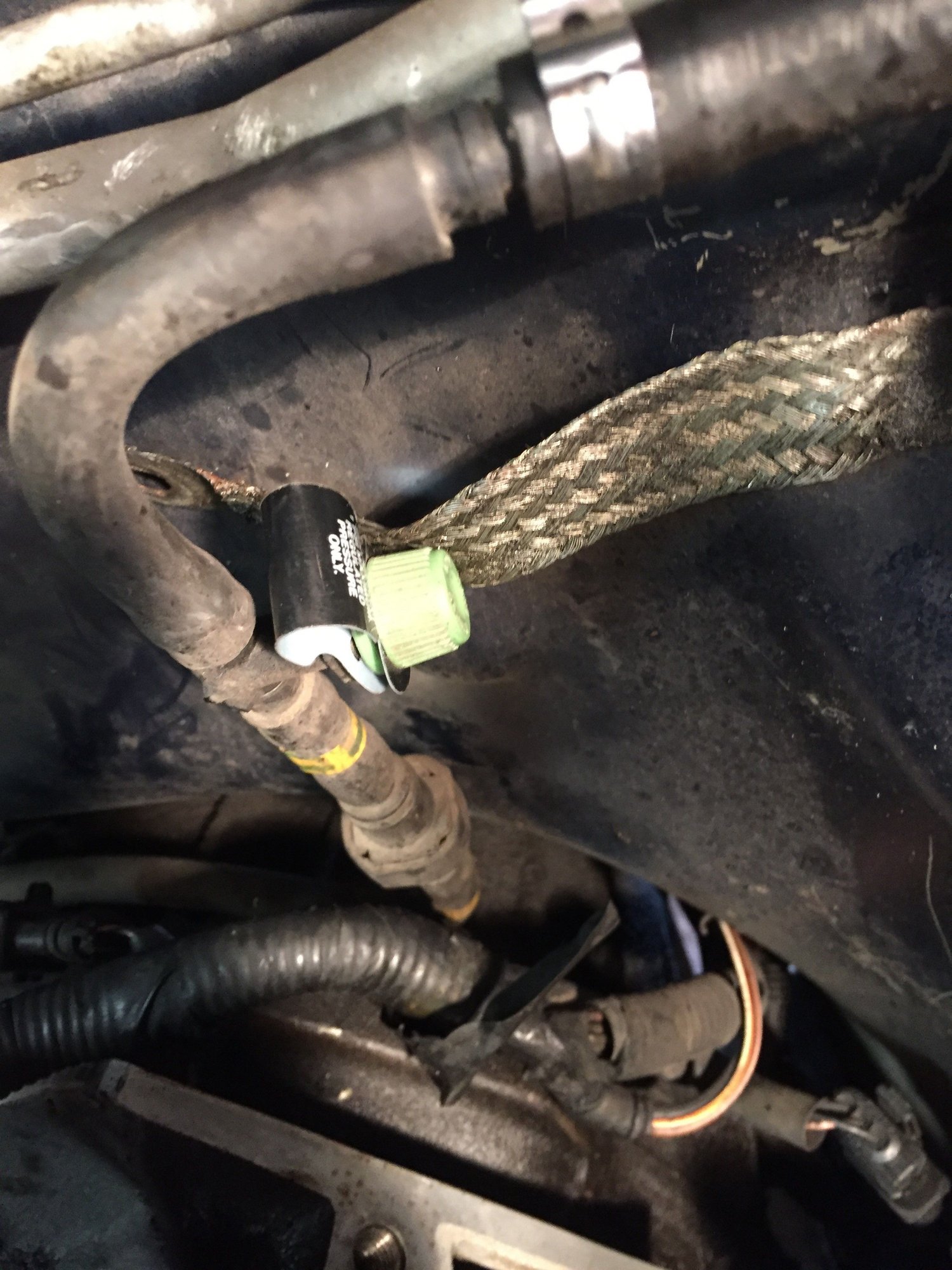

Ok, so me being completely dumb on this subject, and confusing all of you when I started this thread searching for the correct adapter to screw my fuel pressure gauge in..... The valve I was trying to adapt my fuel pressure gauge to months ago was this green capped valve (complete with label tag??) that has to do with the evap emissions system, not high pressure fuel..... Now, that I have torn down my first Rover engine to do head gaskets, I now understand what goes where and how things are routed! lol. I didn't realize the correct pressure test valve port was on the fuel rail under the rear of the upper intake manifold. Sorry for being a dumb azz....anyway
back when I was trying to test the fuel pressure (unsuccessfully) on this particular rover, a friend of mine owned it. I had him take it to our nearest indy shop, they charged 50 dollars to give it a fuel pressure test, 25 pounds. I wish I would have submitted a pic of this valve earlier, you all would have fixed me.
