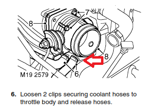

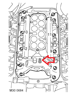

Hello, I am reassembling a 2003 D2 and cannot remember what hose hooks up to this fitting. The fitting is to the right of a multiplug. I have attached a photo with an arrow pointing to the fitting. Please help! Oh, and another question while i'm here, lol, I have no idea how to hook up the two lines to the throttle body. What are these lines? And what are their sources?

All I can tell you for sure is that the arrow in the second picture points to one of the throttle body heater plate tubes, which carries coolant. I can't remember if the one pointed to is the return or the delivery tube, though I'm not sure direction of flow matters.

It connects to the left tube of the throttle heater plate tube.

Looking at the motor, the tube to the right connects to the coolant reservoir tank, hose part # is PCH000420
The tube to the left goes to the top of the plenum part # PEH101540

The outlet indicated in the picture of the upper intake manifold connects via a hose to the throttle body heater, as others have said. It doesn't matter which side of the TBH it is connected to but the standard setup is for it to connect to the left-hand side nipple on the TBH as viewed from the front of the truck.
The other nipple on the TBH connects via a short length of hose (maybe 2") to the nylon pipe that runs to the coolant reservoir.
