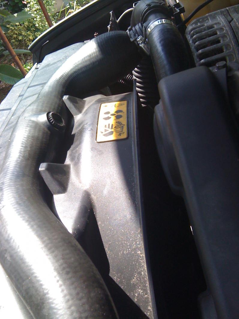

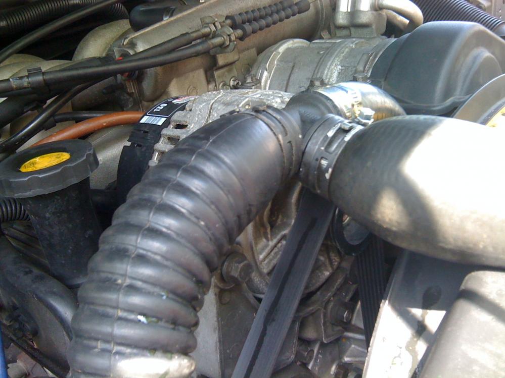

Shut Disco off in driveway, popped the hood and saw the upper hose (the one that attached to the fan cowl was so swelled next to the "T" connector that it looked like it was going to literally burst any second.
9/19/10 - Read throught he workshop manual again and did a lot of searching on here and found out that I should have "bled" the system for air. I followed the directions that I believe, forgive me if I'm wrong, Spike555 posted on how to bleed air out of cooling system. First time I bled it today witht he radiator cap off, then on, then started the car. This took about 10 minutes or so. Drove around block 3 x, parked and hose was really swelled up like before. Let car cool down about 2 hrs, tried bleeding again, same result. Tried a third time this afternoon, this time raising the coolant resevoir, and still same result.
I've checked th "T" and it's not clogged at all. I've attached a few pics of the hose swelling up, this is my first post though, so hopefully I'll get it right.

The reason for the hose blowing up is the thermostat is building excess pressure. Whenever it blows off you always replace the thermostat. and replace the hose and thermostat. Or else.

You should not have a radiator cap. How did you bleed it? If you follow the "how to" method it does not always work. You need to unclip the expansion tank an raise it up on the battery box.
