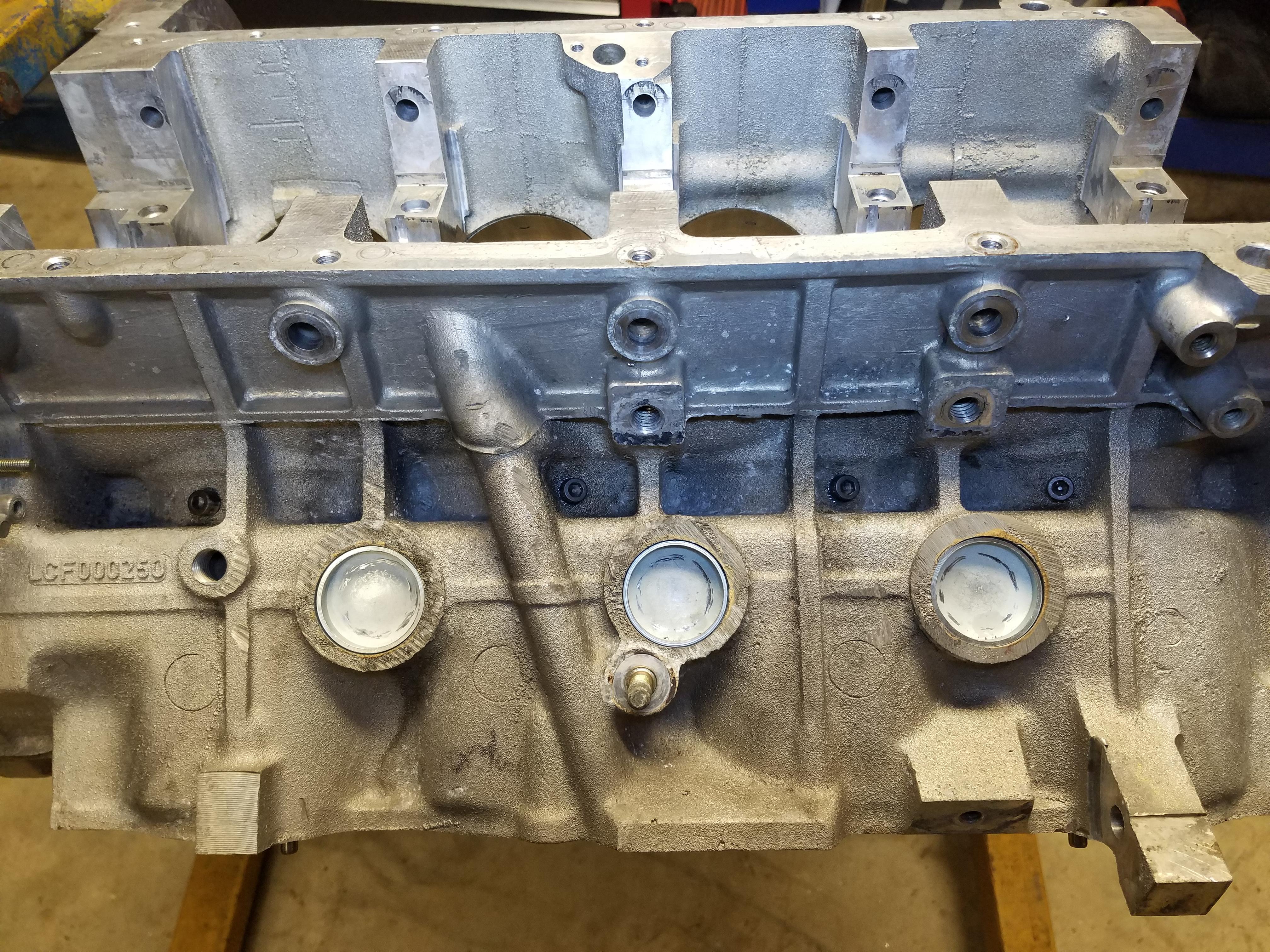

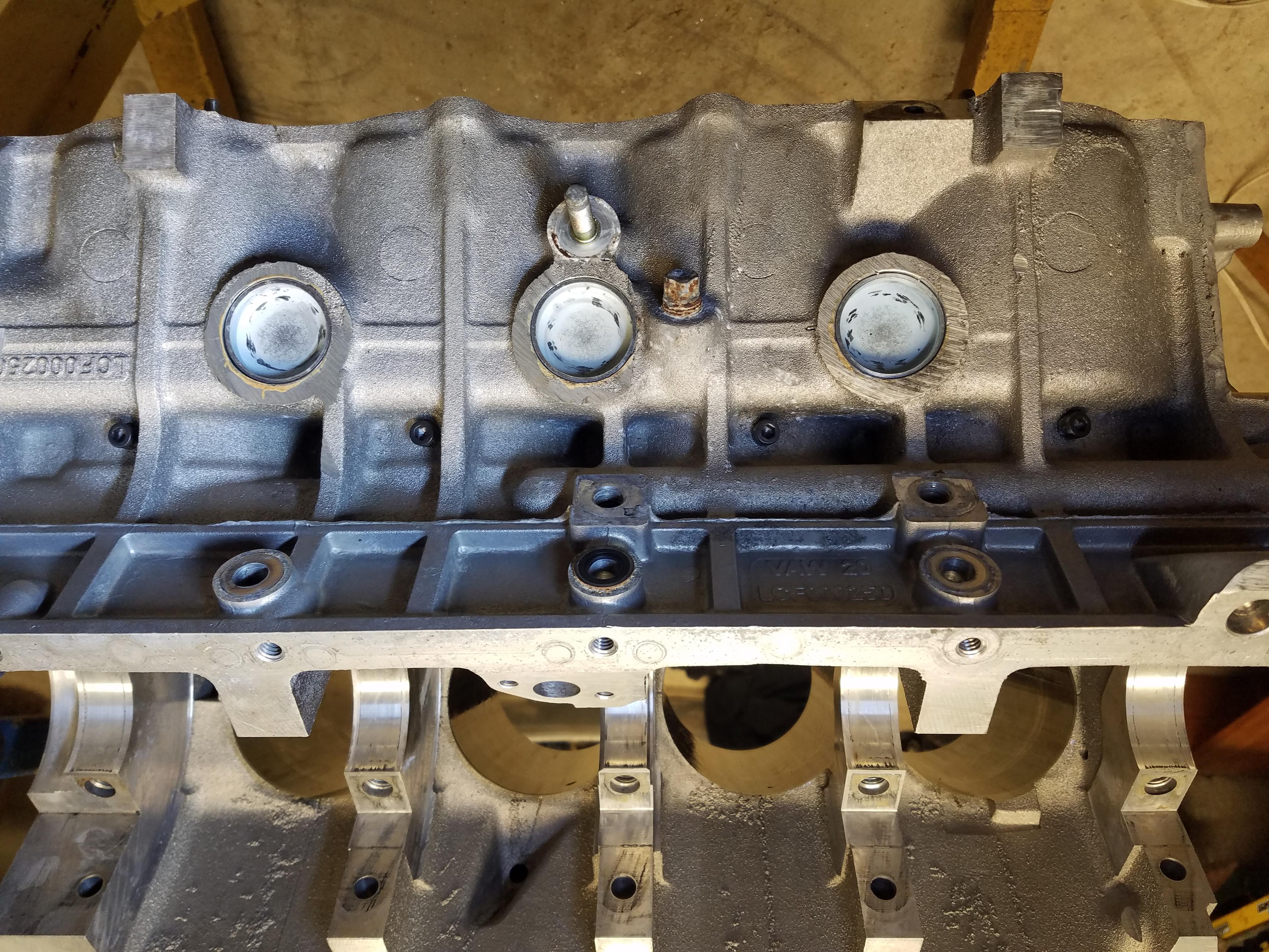

Here's pics of my block, for those that don't know.
You can see the threaded hole next to the serial# on one side, and the plug is still in, and next to a freeze plug on the other.

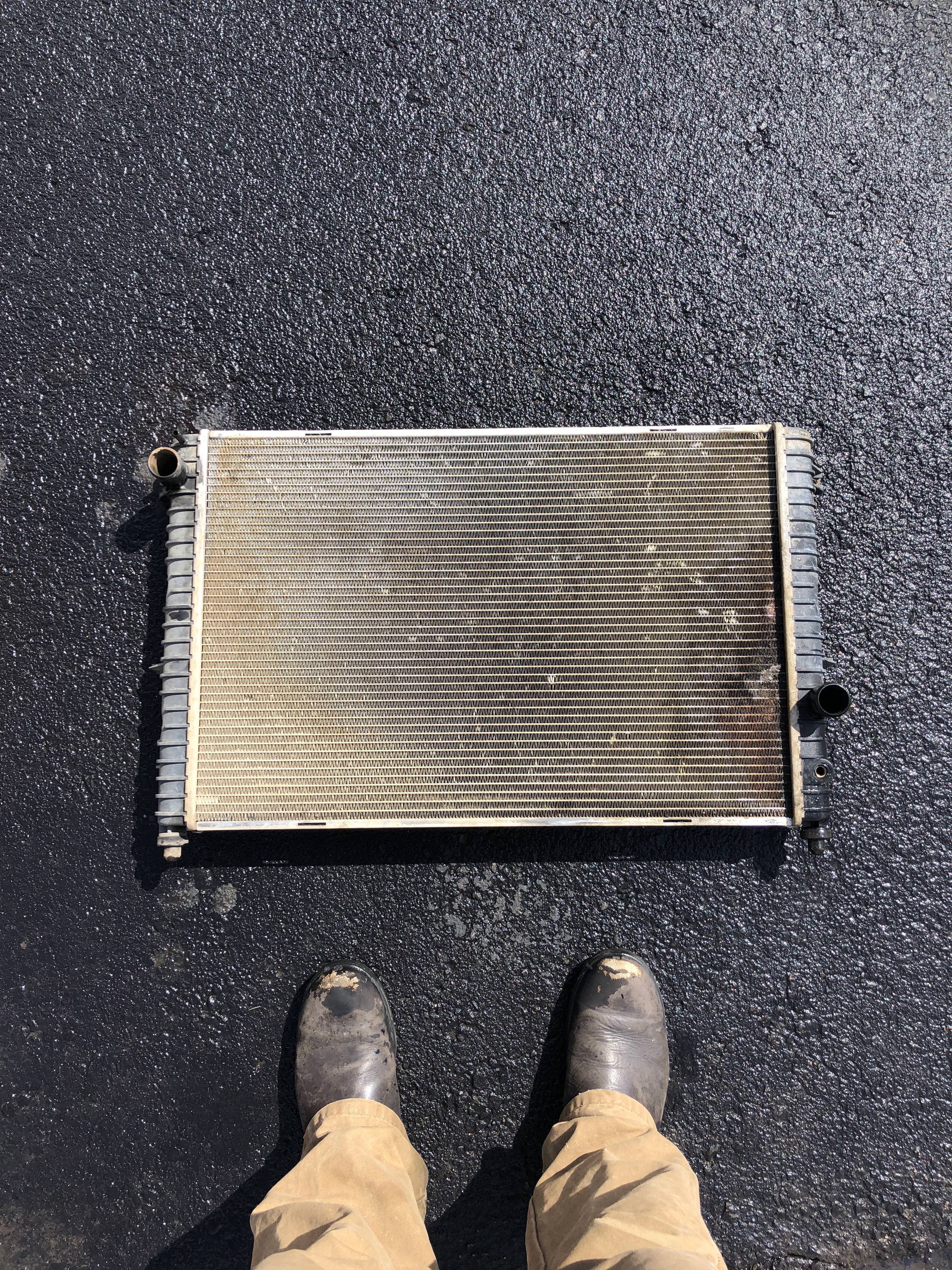

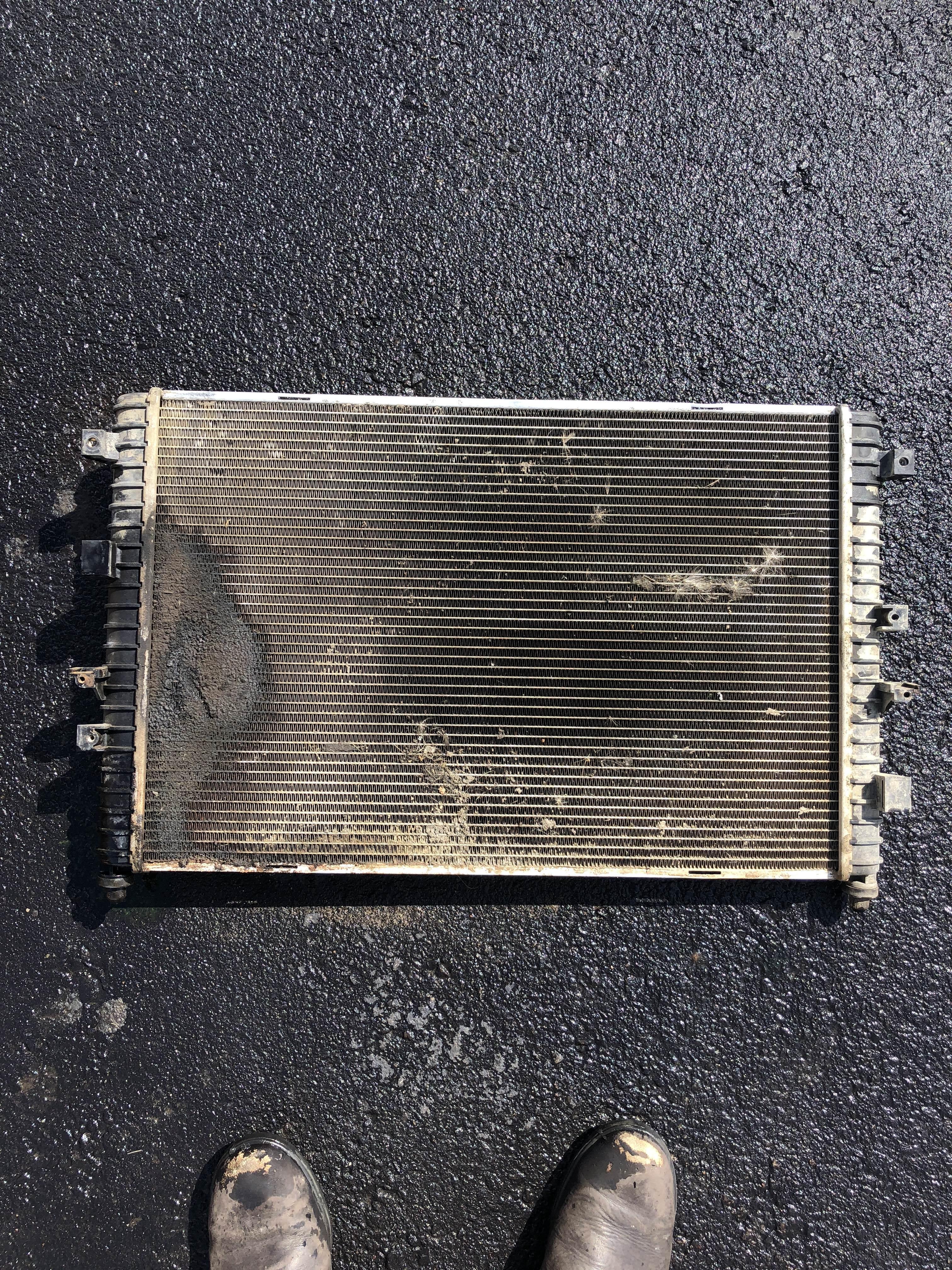

Well, got everything buttoned up today.
Replaced the WP, radiator and fan/clutch.
Taking out the radiator was annoying but not hard. For anyone doing a radiator swap, i'd recommend threading in the course phillips screws into the new radiator before installing said radiator. These screws are the ones that hold everything together basically -- you'll see when you start taking things apart
MOVING on
I'd say there was something wrong with the old radiator for sure..
Engine side

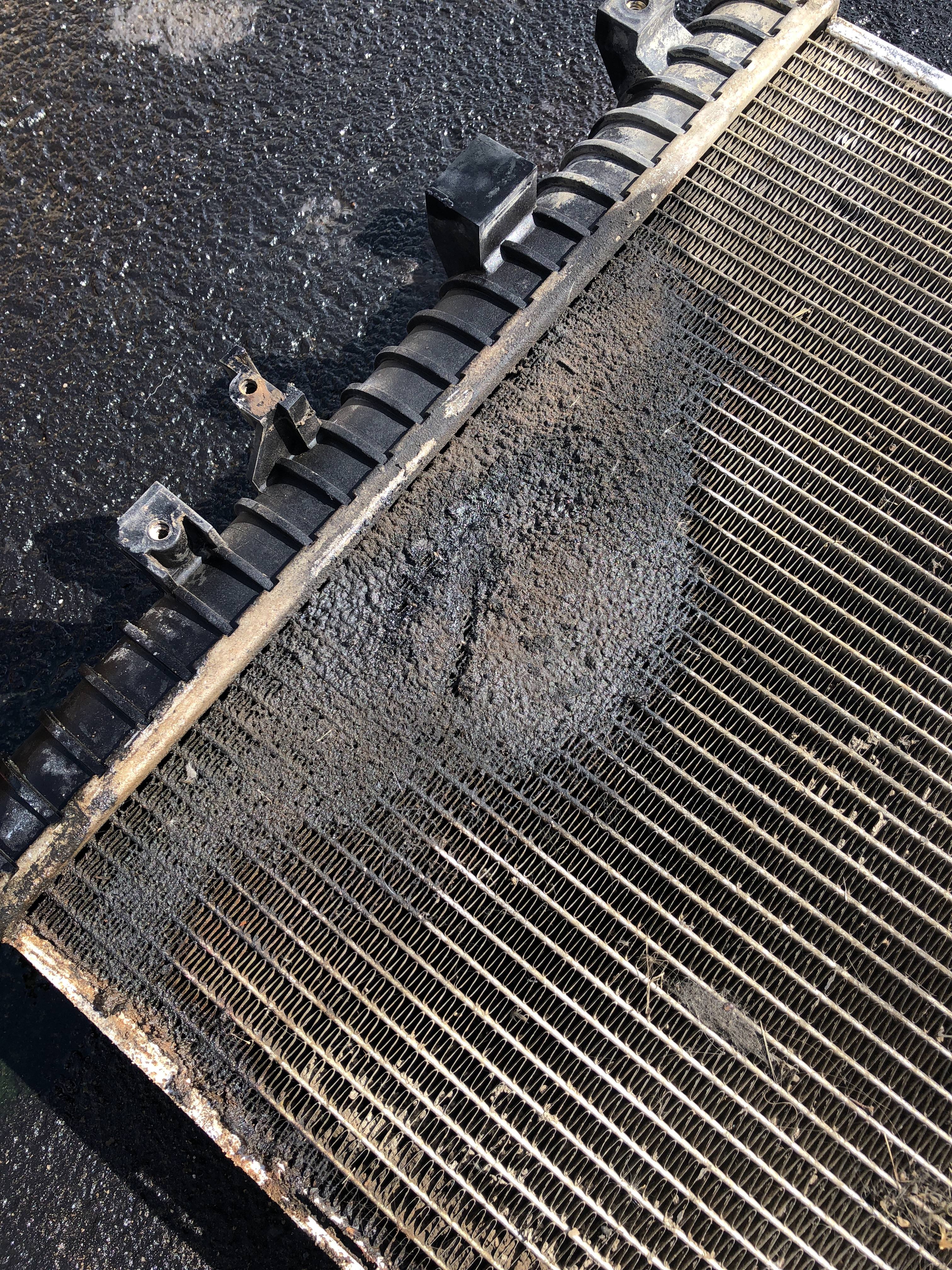

Other side
I'd probably say that 30-40% of the radiator was mucked/blocked up -- It appeared to be oil but the oil coolers that sat right in front were completely clean so i dunno what it was. There was mud also. Temp sensor had a nice film of some build up on it, cleaned it right off and reinstalled it.

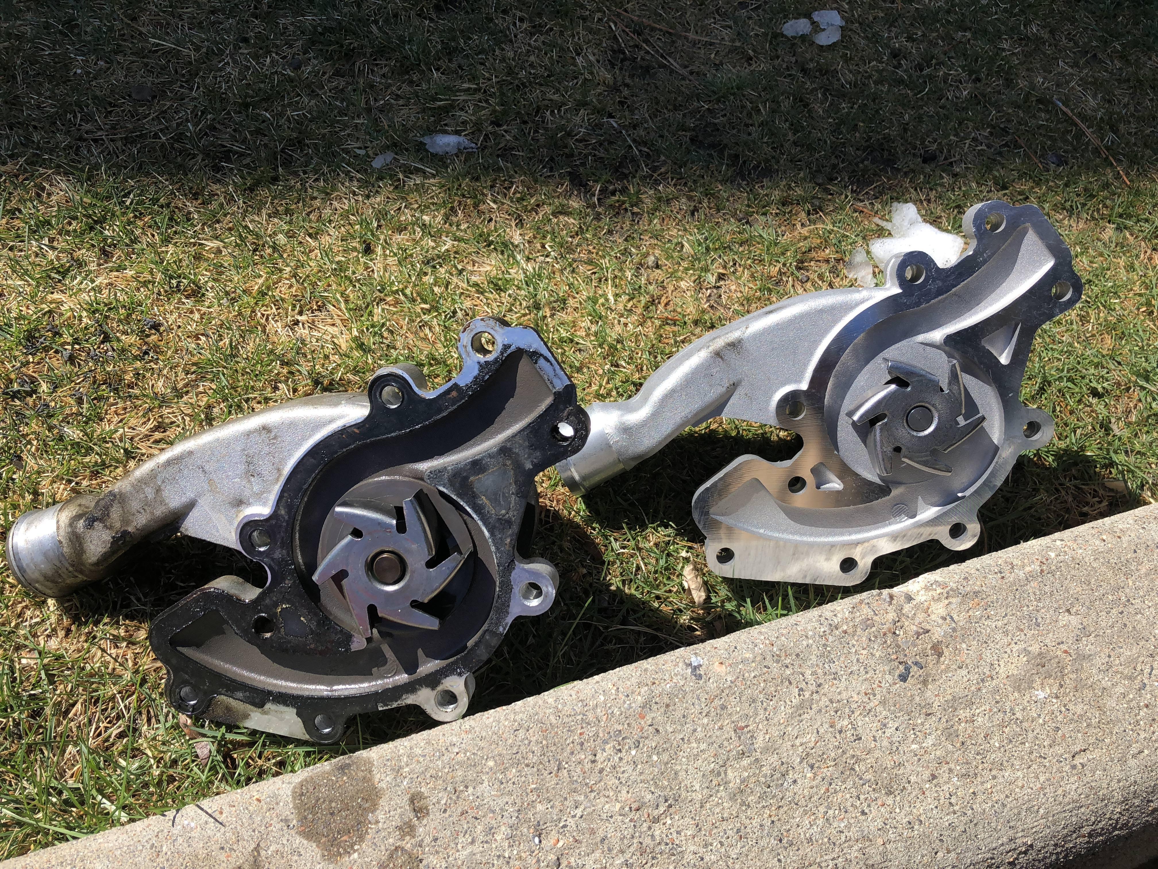

Old WP appeared to be fine, gonna keep it as a spare.

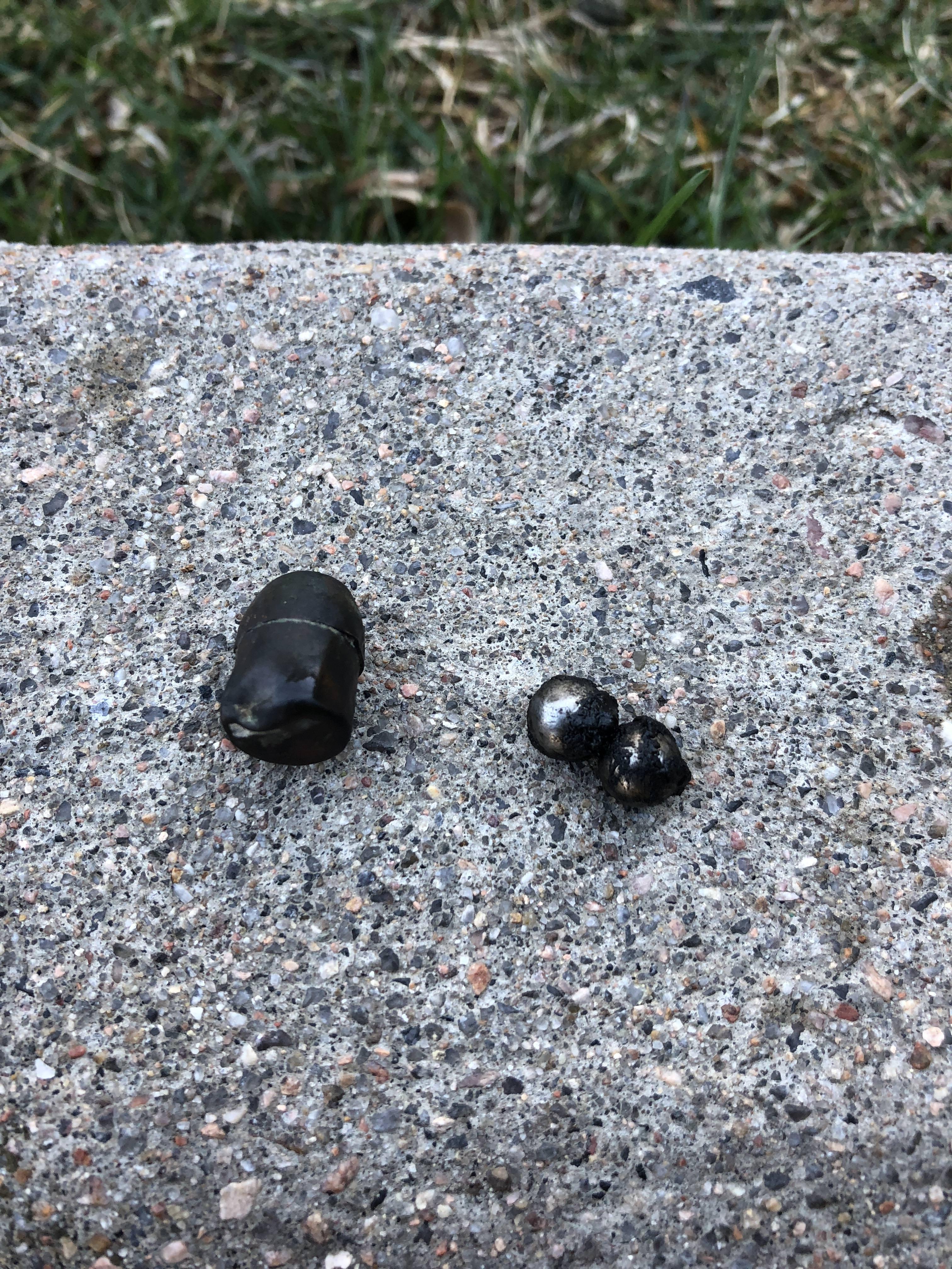

While changing out the pump i found a bullet and 2 ball bearings just hanging out on the exterior of the engine

It's amazing how much crud builds up on the fins of the rad. I spent 30 mins with my hose clearing it all out. I was also shocked at how much crud was inside the rad as well. I'm pretty sure that removing my rad and cleaning it out helped more than changing out the 190 to a 180 t-stat.
