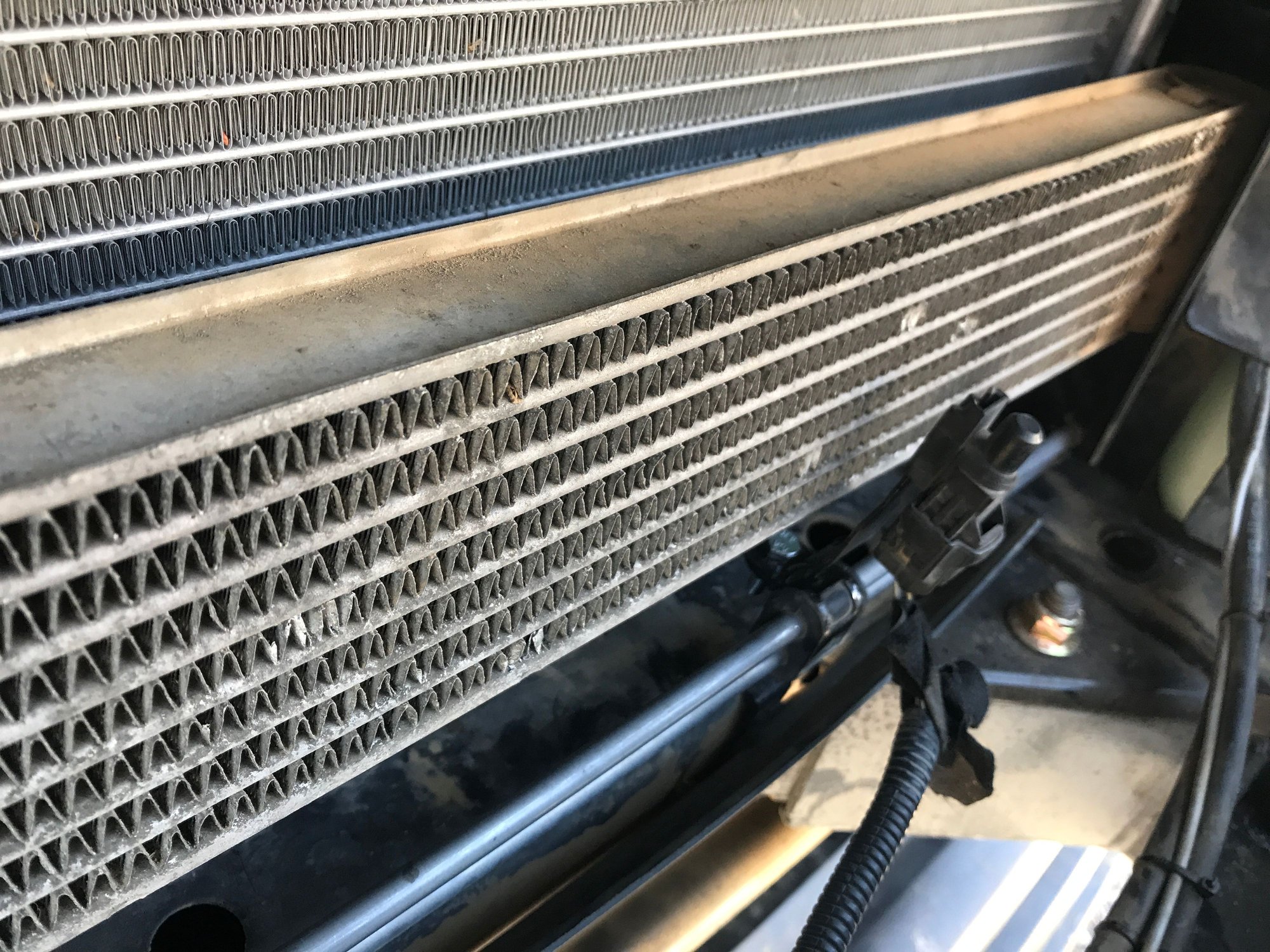

Pulled the condenser and fan today. You can just barely wiggle it out with the radiator popped off its bottom mounts and leaving all the pipes and hoses connected. BIG difference in airflow, and temps. I'm not idling above 200 anymore. I used to idle 203-206, now I idle 195-197. The condenser was also caked in dirt so maybe that contributed to the problem.
With the condenser gone, there's no way to mount the fan without making something custom. You also need to relocate the ambient temp sensor to somewhere else.
bonus: pretty sure the power steering pipe can now be serviced from the front with the condenser gone, and possibly even the oil and transmission cooler as well.

Project complete. The last little hack I did was grind the welds off the temp sensor bracket to the support bar and remove bracket. The hole where the wire ties went becomes the mounting hole. Bend it to 90 degrees, then affix to the power steering pipe bracket.
Toss the condenser, two support bars, AC fan, numerous brackets, and dozens of bolts/screws.
