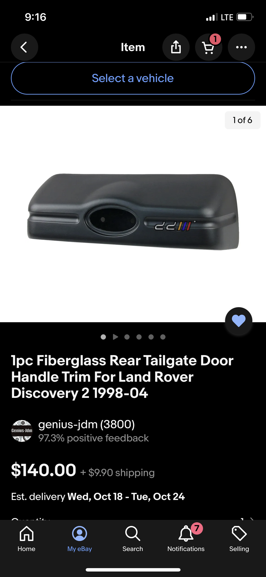

Has anyone installed one of these fiberglass rear door handle pieces
Old Oct 10, 2023 | 09:19 PM
Frank4's Avatar
Joined: Feb 2009
Posts: 1,200
Likes: 183
From: MEMPHIS, TN
Default Has anyone installed one of these fiberglass rear door handle pieces
Just received this and was wondering if anyone had any trouble with install/fitment.

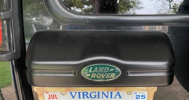

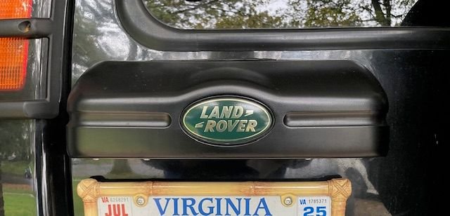

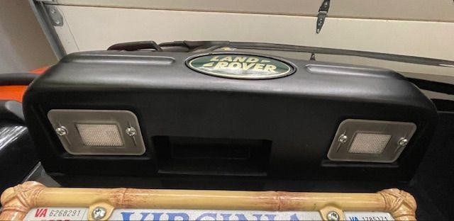

I installed this fiberglass one this past March. It's amazing quality, however you will not be able to use the factory rubber gasket with it because the backside that mates to the car body is different than the factory part. I wish I had a picture to show you of the differences, but I never took one. I used some
butal cord butal cord
to make the seal and it works just fine. I also installed new
led plate lights led plate lights
while I was in there, as well as sanded and painted the door handle.
