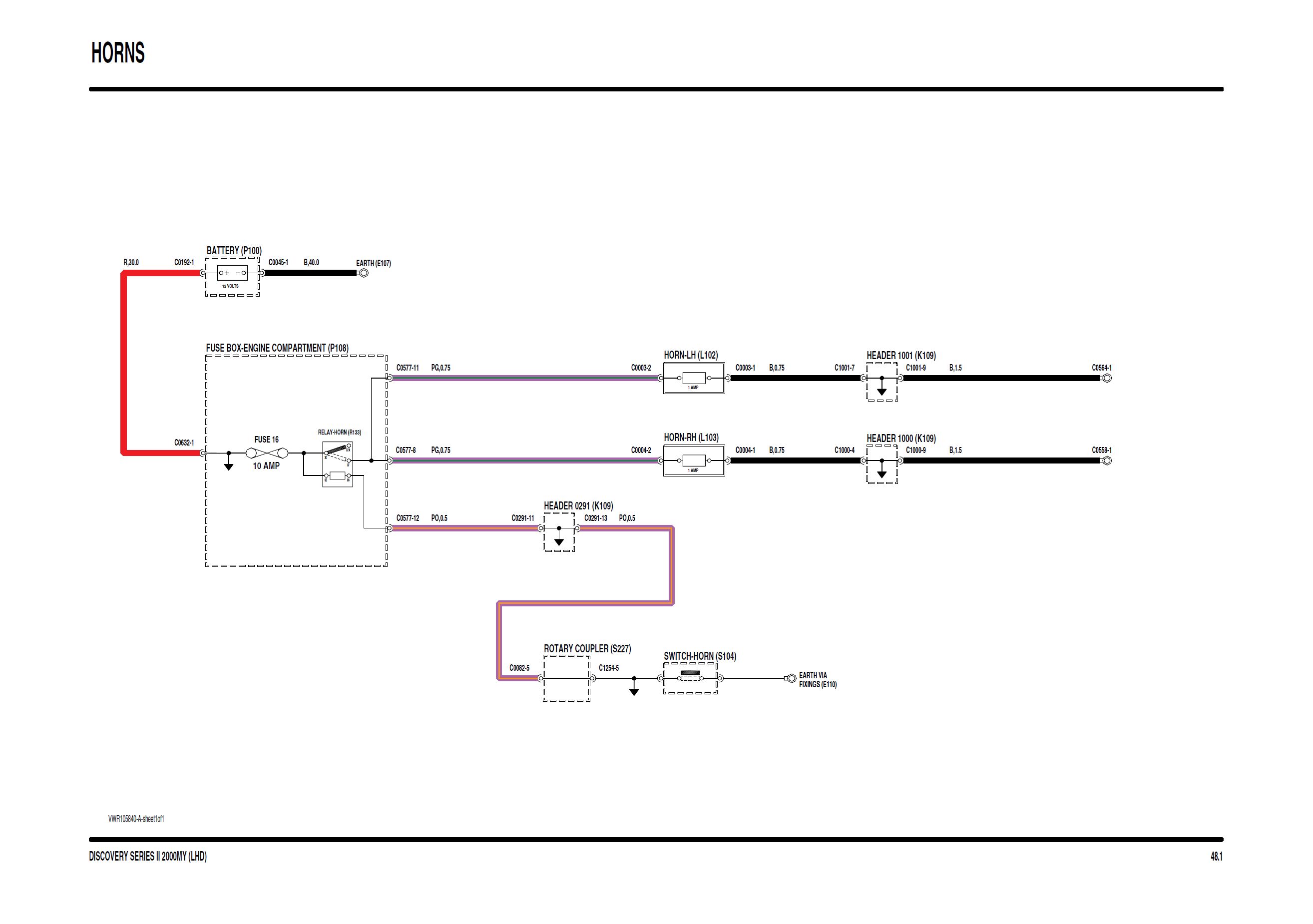

its a fairly simple system, here is the wiring diagram. its probably short to ground on one of the two feed lines to the horns from the relay in the fuse box, or a bad horn shorting internaly. will it still blow the fuse with both horns disconnected?
