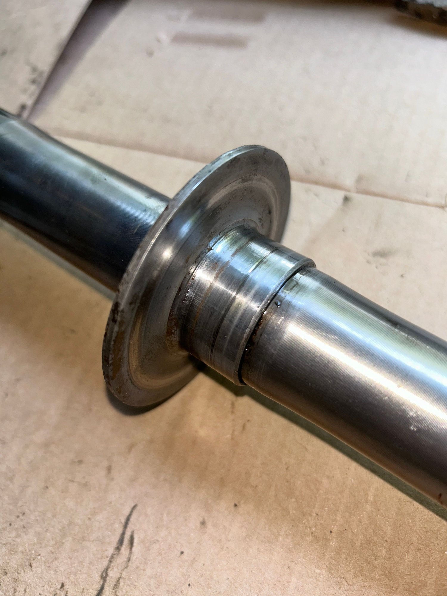

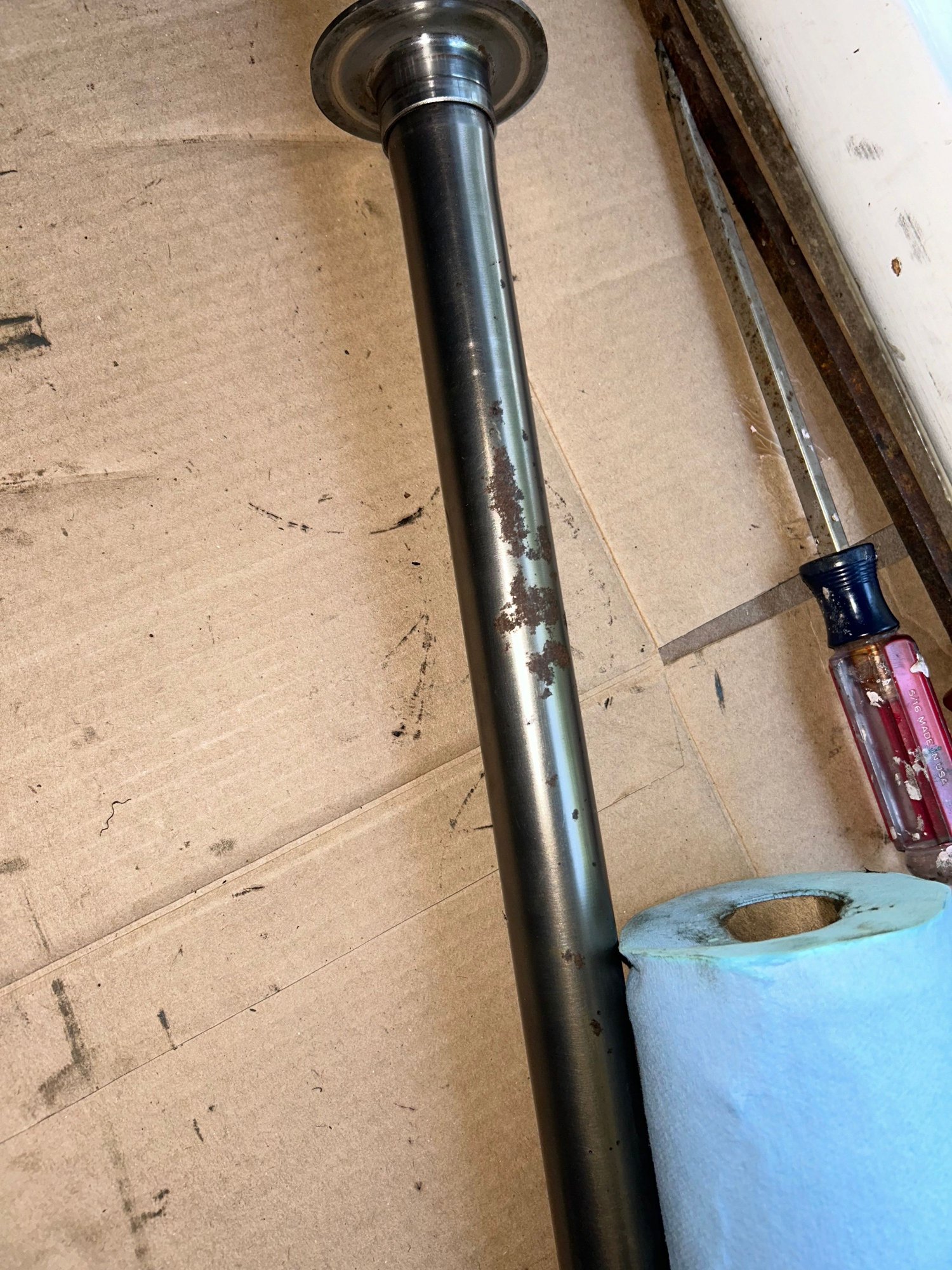

While replacing the CV boot I noticed some rust and wear on the half shaft. This is the front driver half shaft. Should I be concerned with either? Should I sand down the rust?
Wear
Rust

The rust on the axle looks pretty superficial to me. A light sanding would be fine. It looks like the axle sat without turning for a while. I would certainly reuse it.
Old Apr 2, 2024 | 08:34 AM
The_OGCJR's Avatar
Joined: Feb 2014
Posts: 808
Likes: 172
From: austin texas
That’s a mere flesh wound! Seriously, Id scrub with a green pad and water (no chems) coat it with diff fluid and re-install
