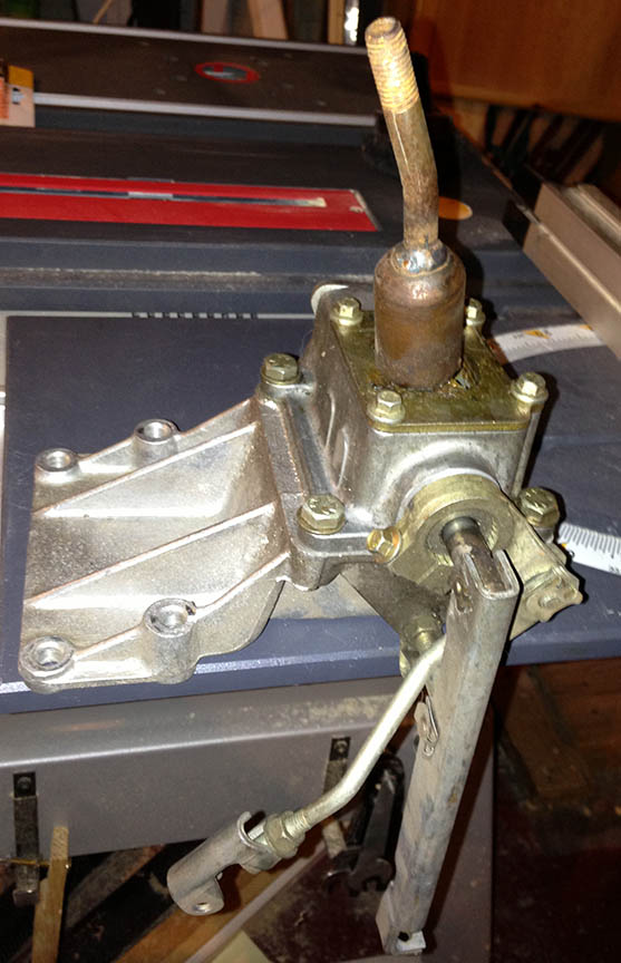

Either your switch is bad, disconnected, or your truck originally came without CDL. The prior owner may have put in a D1 box which may have not had the provision for the high/low switch which really just detects low. You can see the switch in the D2 txfr case on the left (green wires coming out) and the D1 case on the right not having it. If you crawl under your truck you can feel around for it.

Which way up are those in the picture (and thanks for the picture)?

Ah figured it out from the rave, that's top down from the front. So the 2002 doesn't have a differential lock but the '96 does. That round thing with the three bolts on the right bottom of the image…
Okay, I'm learning.
