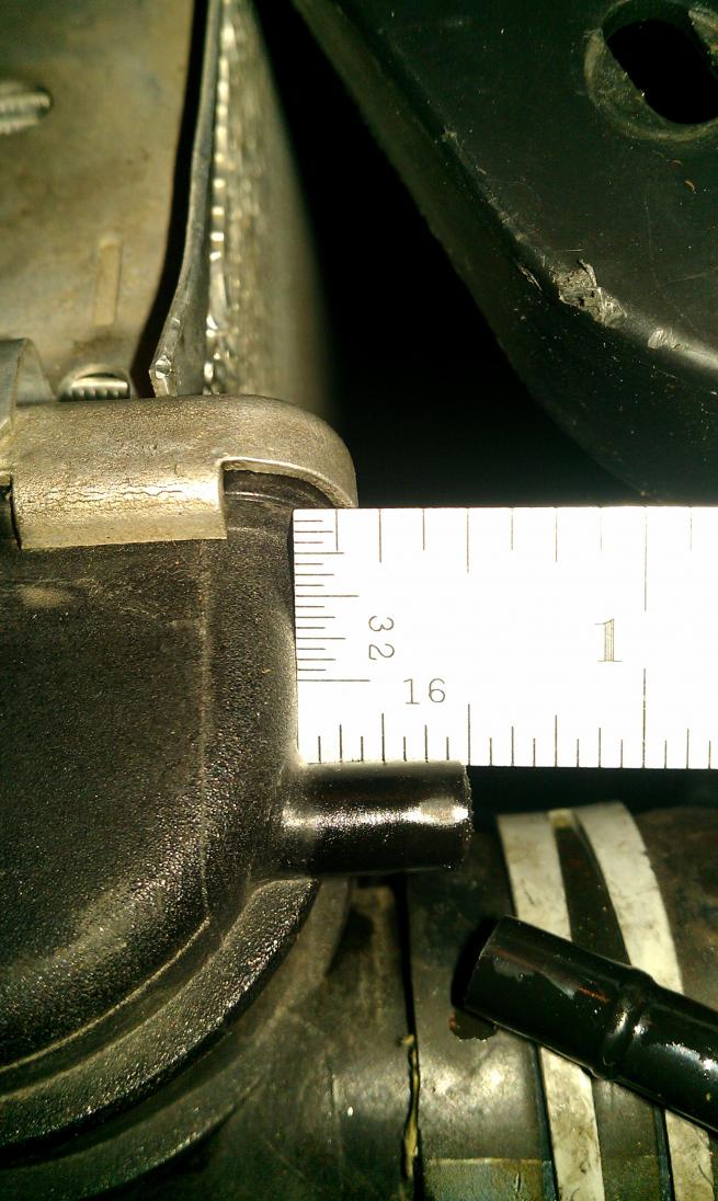

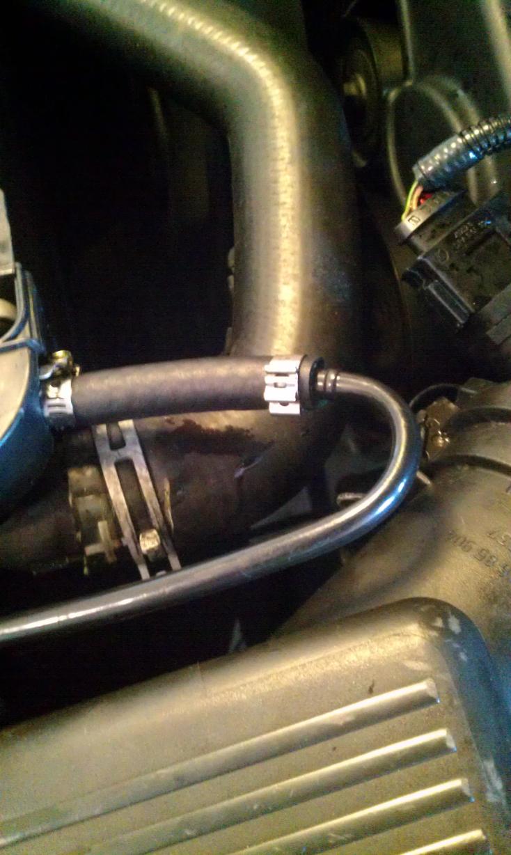

Put in Soft spring thermostat but truck slowly overheats. I shut it off at 208F the small hose going to the expansion tank from the top of the radiator was dripping. Put new hose on (See pics) couldn't pull it off but it still drips and engine overheats. Does this look broken or sawed off seems a bit short to hold pressure from the radiator.

I am concerned about the length of the nipple on top of the radiator but much more concerned about stopping it from overheating . I had the top fan shroud off also. Radiator temp had about 5 degrees temp diff top to bottom. I think?/ I took several readings and got different results. But none more that 10 F.

Does it look like the little nipple on the radiator was broken or sawed off? Or should there not be very much pressure on there? Or maybe it;s the expansion tank cap?

Buy a test kit to see if you have exhaust gasses in your coolant. Couldn't tell you at the moment if that tube is too short or not. Will take a look at mine when I get a chance and let you know if someone else doesn't answer first.

Nipple will be brittle also. Use care.
