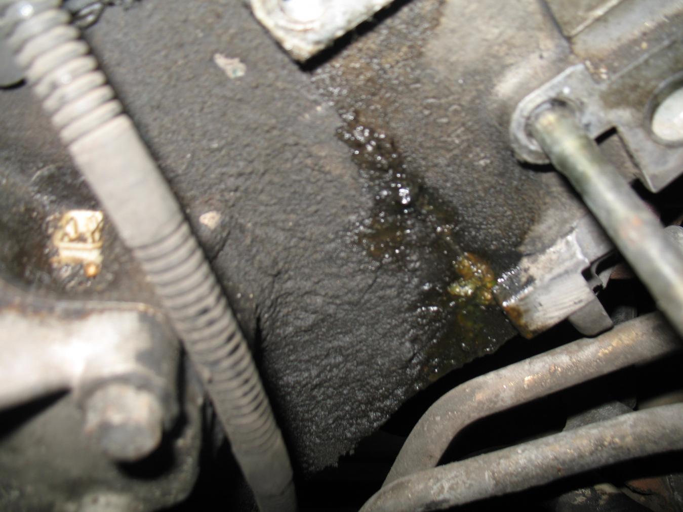

Default Pics Head gasket leak
I think I may have found my leak. I'm not pic savvy on here, not sure how to put more that 1 pic in Probably a size thing.. Yea its always about size
What do you experts think?

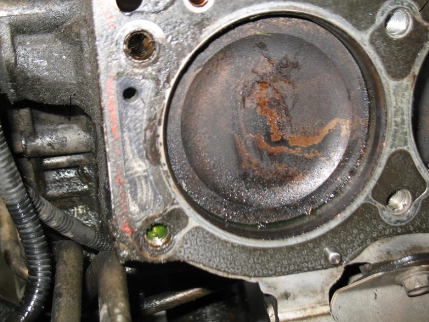

Old Apr 15, 2013 | 04:52 PM
  #25
slabrat's Avatar
Joined: Jul 2012
Posts: 486
From: Kaintuck ee
Default more pics
Need for the experts to give a look and see if you see anything bad. Valves look a bit burnt . THe head gaskets were changed one before . The bottom coil pack bolts one head bolt was not torqued very tight and 2 exhaust bolts were finger tight.

Old Apr 15, 2013 | 05:05 PM
  #26
slabrat's Avatar
Joined: Jul 2012
Posts: 486
From: Kaintuck ee
Default DS front Head Gasket
Think I found i may have found it.of pic left .
Smoking Gun ????

Old Apr 16, 2013 | 12:22 PM
  #27
jfall's Avatar
Joined: Mar 2012
Posts: 3,171
Likes: 45
Coolant in the hole means nothing. It just spilled in there.
You need to look at the old head gaskets.
CRITICAL.
You MUST get ALL the coolant out of the holes.
If not- hydrolock and you will strip the head bolt threads or worse trying to go the 2nd 90 degrees.
Valves don't look burned. That's just how they are after a lot of miles.
You can get carb cleaner and a wire brush and carefully remove all that.
Make sure it turns out all clean

Old Apr 16, 2013 | 12:24 PM
  #28
jfall's Avatar
Joined: Mar 2012
Posts: 3,171
Likes: 45
you may be able to remove the coolant in the head bolt holes via compressed air.
Or take a shop towel and make it into a spear by twisting it and carefully get it down into the hole to soak up the coolant and pull it back up.
be careful tho.
Or get long Q-Tips..
Old Apr 16, 2013 | 01:56 PM
  #29
pinkytoe69's Avatar
Joined: Jan 2012
Posts: 1,126
Likes: 11
From: mini soda
Compressed air should work fine.
Blow it out, blast brake cleaner in, blow out again.
Old Apr 17, 2013 | 05:49 AM
  #30
drowssap's Avatar
Posts: 9,298
Likes: 318
From: Boston Strong
blow the hole out with air, otherwise you will run into hydrolock when try to tighten the bolts.
