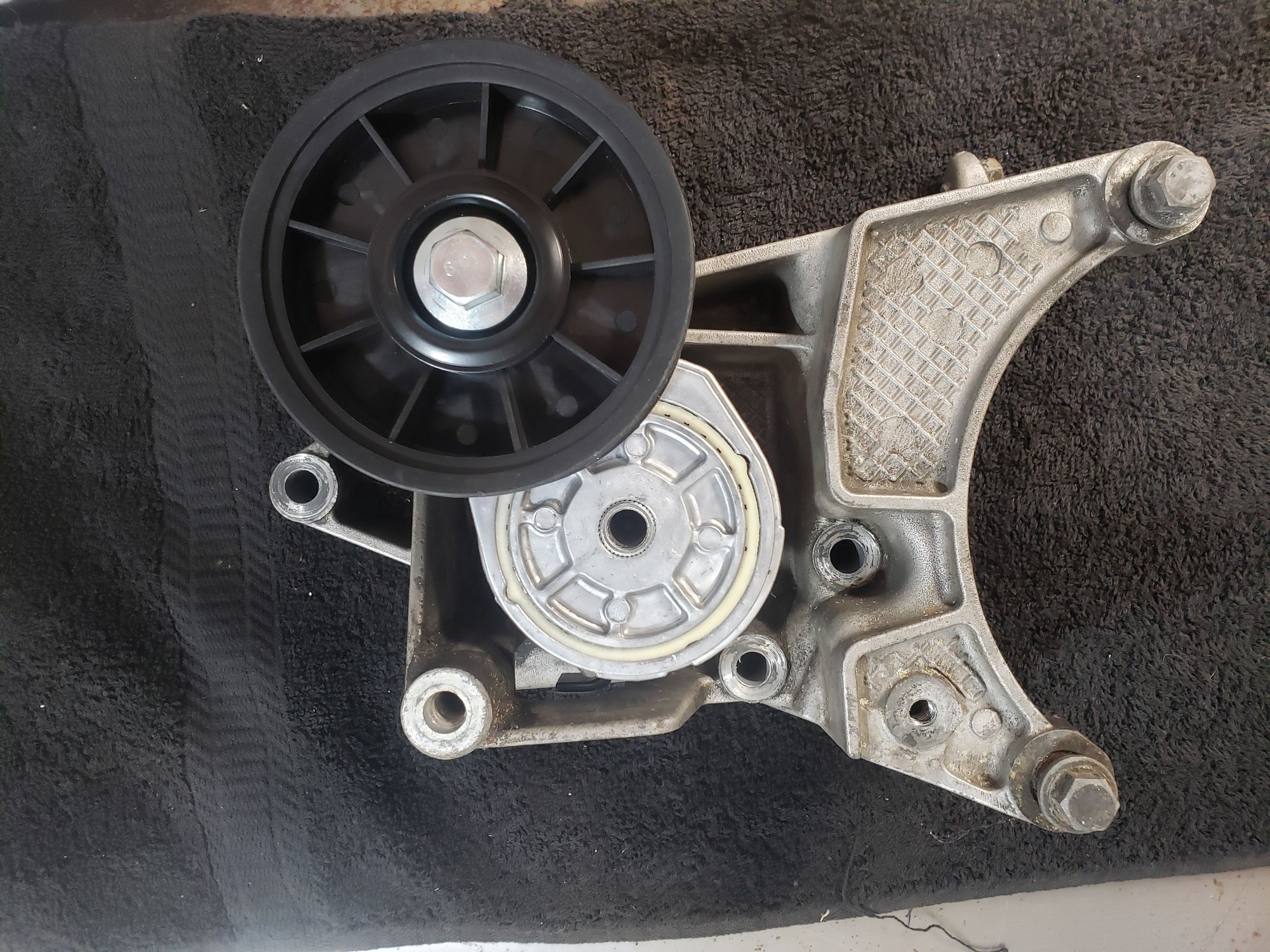

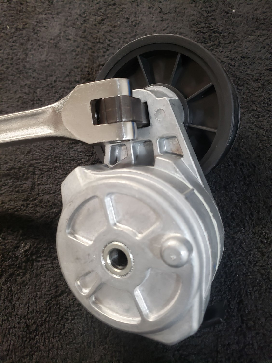

Here is the belt tensioner, it bolts to the alternator bracket, and has a square fitting on the back side for a 1/2" drive ratchet or breaker bar.
Put the breaker bar in and pull(it only goes one way) and the tension is released and you can lift the belt of.
Remember to take the fan off and power steering pump pulley bolts out first, as you need belt tension to hold them both for removal.
