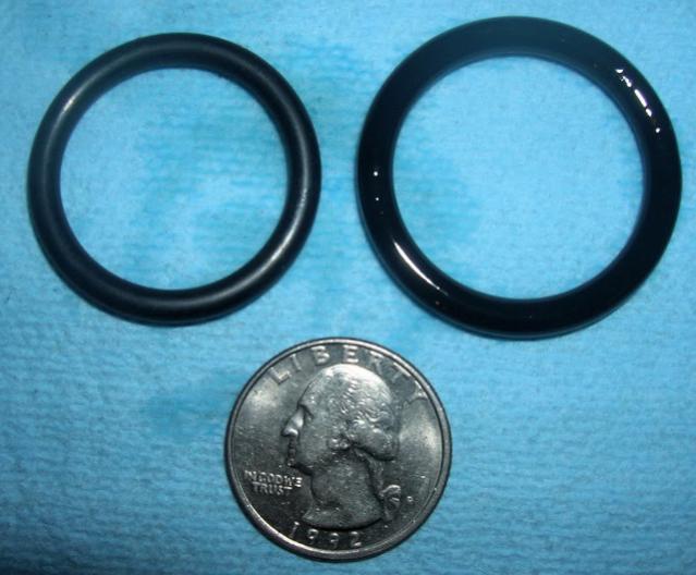

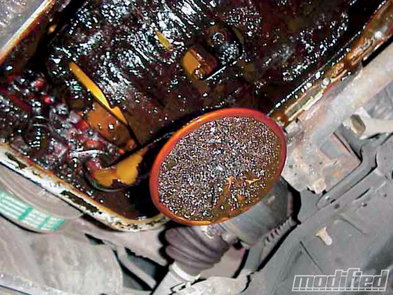

If the rear seal some White Shepherd (now Blue Devil) rear main sealer may help, that's a lot of rubber and the product makes it swell. Also be sure your PCV vent in passenger valve cover (oil separator) isn't clogged, which can make a slight pressure in the vented area of the engine, making seals have pressure that is not normally there and leak. Pix of 2 O rings, one soaked in White Shephard.
