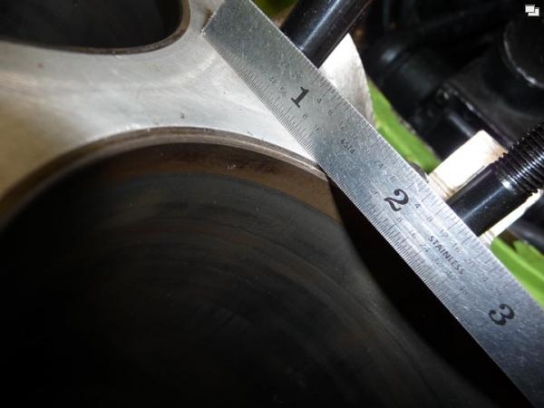

Some that have elected to skip the machine shop have regretted it later, the spec for flatness is .002 inch, or about 1/2 the thickness of your printer paper. However, if the tick is caused by slipping sleeve, HG alone may not fix it. We have threads about pinning the liners.
