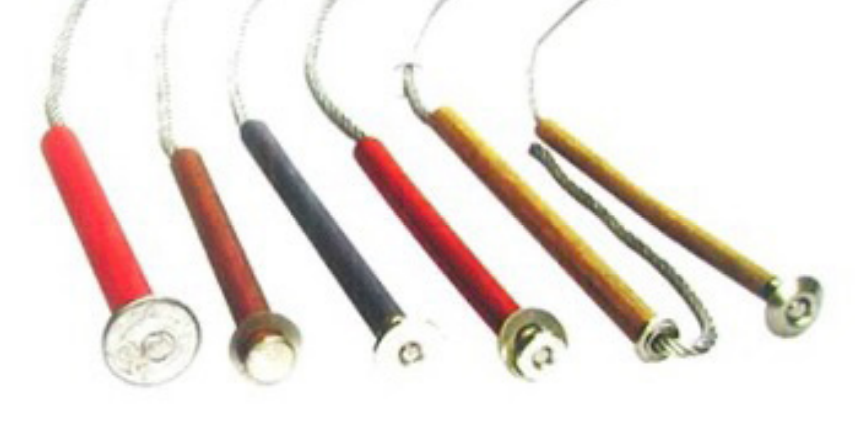

I solved the rattle by installing the high voltage fuse cap nuts the electric utility discards. (Lasted 10 years so far) Ask any electric utility truck you see stopped around for them. Dealing with removing the rusty original fastener is another story.
Hat shape threaded nuts at the tips of fuses, several flavors :

Old Jul 7, 2025 | 09:42 AM
