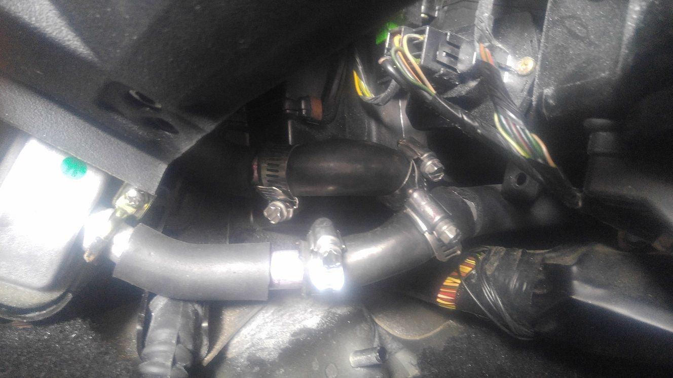

This is what I did:
Here is more information
https://landroverforums.com/forum/di...hot-air-83856/

I copied FridayNightDisco's idea. I found it impossible to get the orings and clamps at the heater core to seal without removing the heater core and working in an open space.
Cut an inch or two out of the aluminum pipe and then used heater hose (clean inside of hose and pipe for clean tight fit) to join them back up. New clamps tightened very tight and no leaks.
