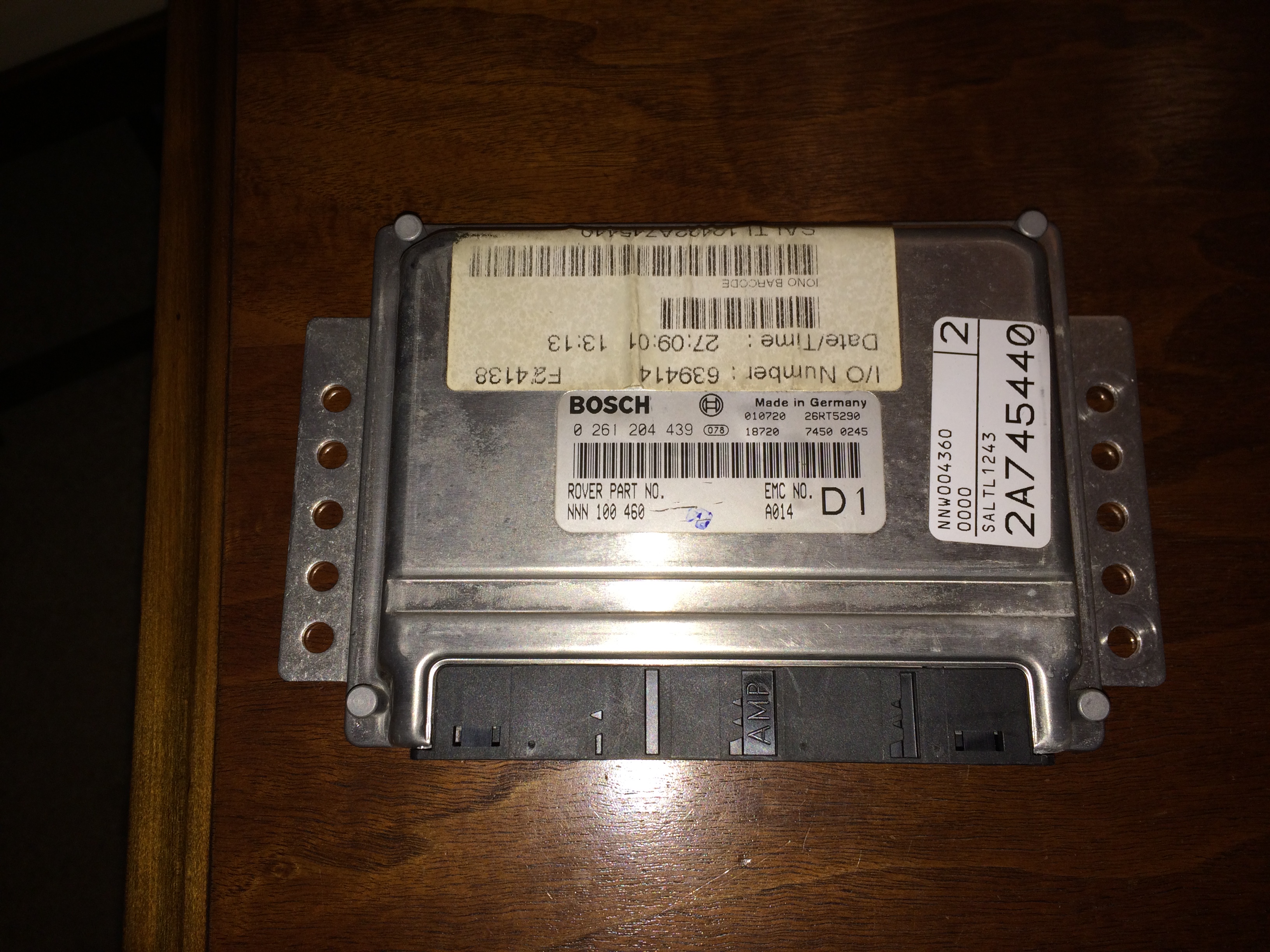

So, everyone thank you for the advice and assistance! Just to follow up, the ECU has been successfully swapped and truck has been driving around Still have my O2 issue... however I am confident that the shorted computer also took the sensor with it. I know that they are sensitive, so I'll head out and grab one tonight / tomorrow.
But just to verify - nanocom CAN do the security learn and the ECU swapped no problem. steps:
1. swap ECU (disconnect battery)
2. go into the nanocom and under 'motronic' - 'utility' - 'security learn' SET
3. power off, cycle the power on the truck...
4. should start up right away.
AND done!
