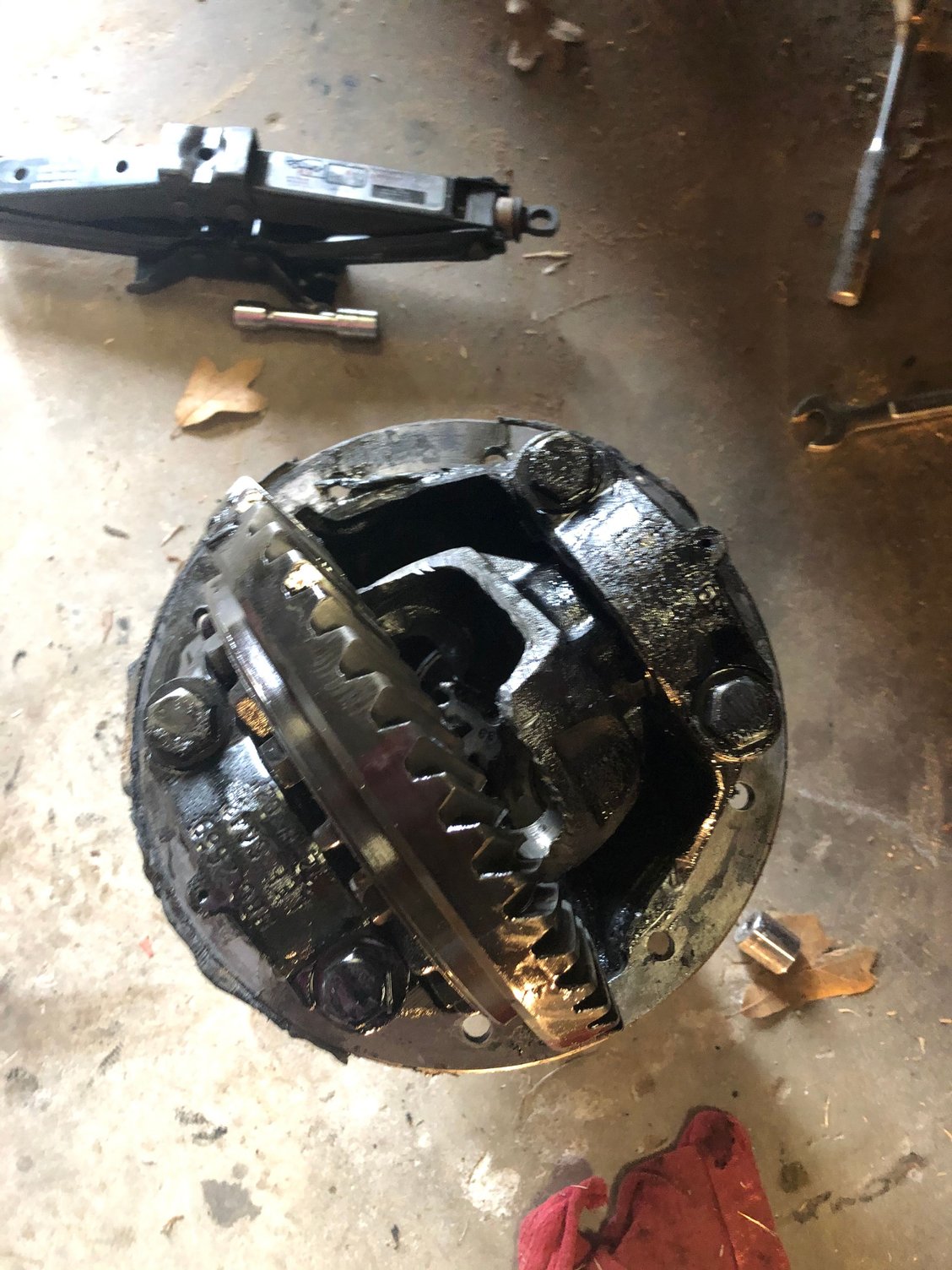

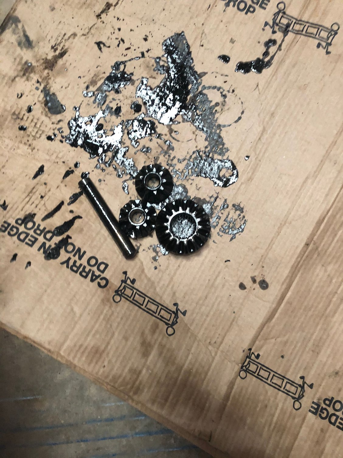

I have a 2003 disco II. I recently replaced the old diff with one I bought off eBay.(other had bad failure see pics). I also changed front left axle. Before the failure the rover ran and shifted fine. Now that I have it all back together, I only have reverse, and if I put it in 1 it will drive. If I put it in 2, 3, or D and press the gas it won’t go. How can this be a bd transmission if 1. There were no signs of problems from the tranny before diff went out. And
B. All gears start in first so it should go in 1, 2, 3 and D because it has to pick up first gear first. Am I wrong? Anyone have anything like this happen?! Anyone know how to find disco mike???!!! Please send me ideas!! I’m stumped!
