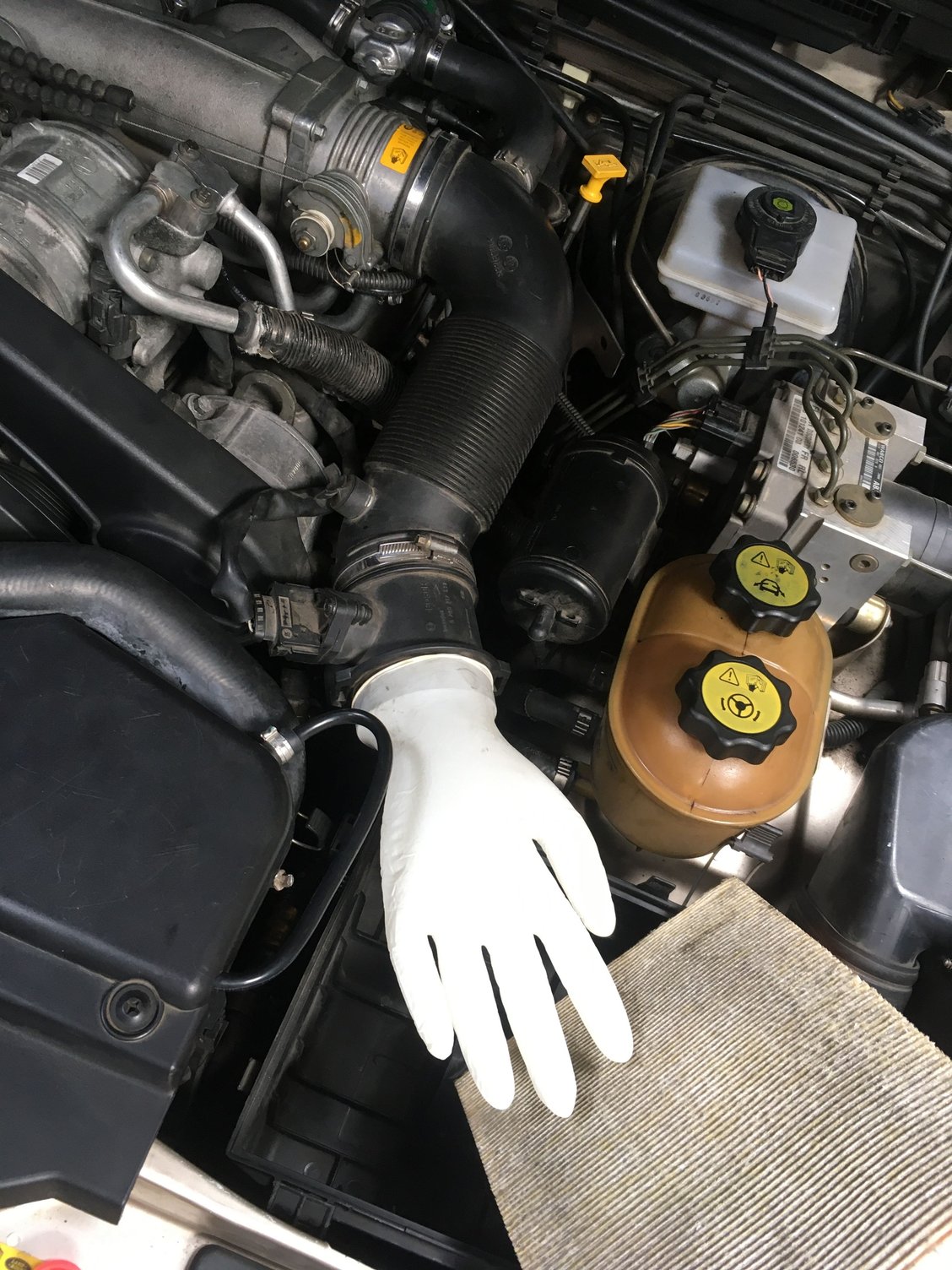

I got rid of the P1000 codes.
I changed spark plugs, plug wires, both ignition coils, and fuel injector for cylinder #4. Seems to have done the job.
The original codes were :
1000 (75) Catalyst Damaging Misfire Multiple Cylinders
P1000 (66) Misfire Cylinder 4 with Cylinder Cutoff P1000 catalyst damaging misfire cylinder 4
P1000 (62) Emission relevant misfire multiple cylinders
P1000 (53)
Right after solving that problem I got 2 more codes: p1000 (80) and P1417. I changed the solenoid for the secondary air injection. The solenoid was toast, hopefully all else is working.
I'm looking forward to 2 consecutive days driving with no codes and no SES light.
All hands were required to pump and capture smoke while tracing possible leaks in the secondary air injector.

What's the black cylinder between the air intake tube and the power steering reservoir? Looks sort of like an SAI pump but it's in the wrong place.
