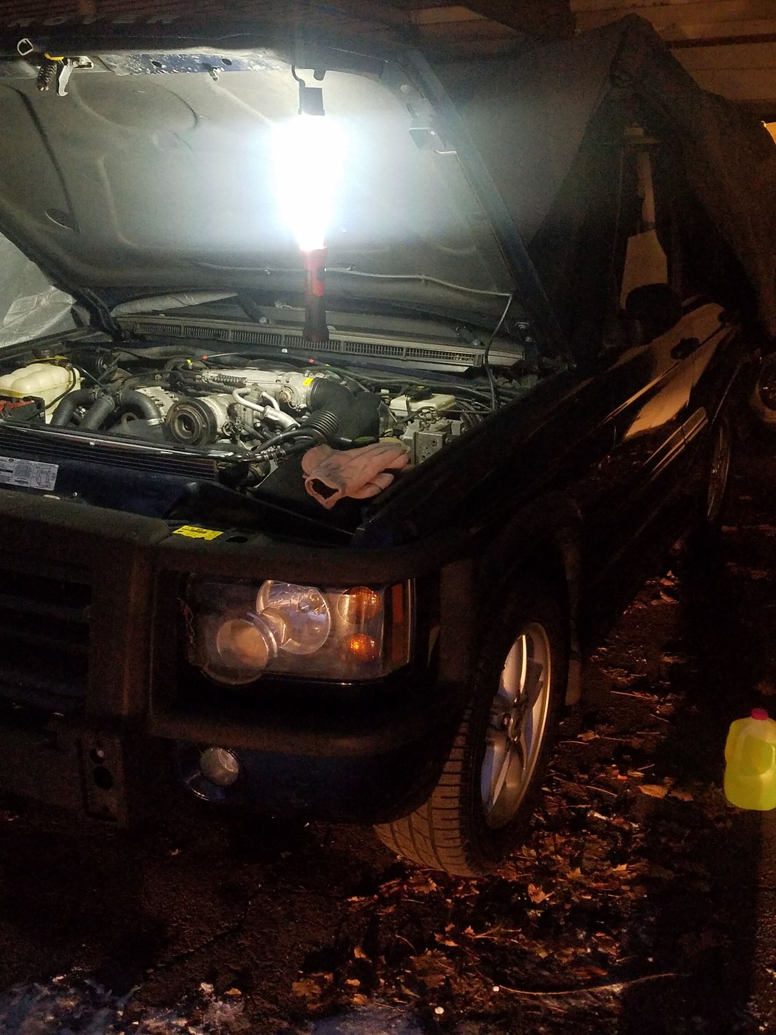

Remove the oil fill cap and tell us what you see under it. And also look down the oil fill neck with a flashlight. Anything lite green there?
AR asked about oil leak dye, what about any Oil Stop Leak/or Oil Additive?

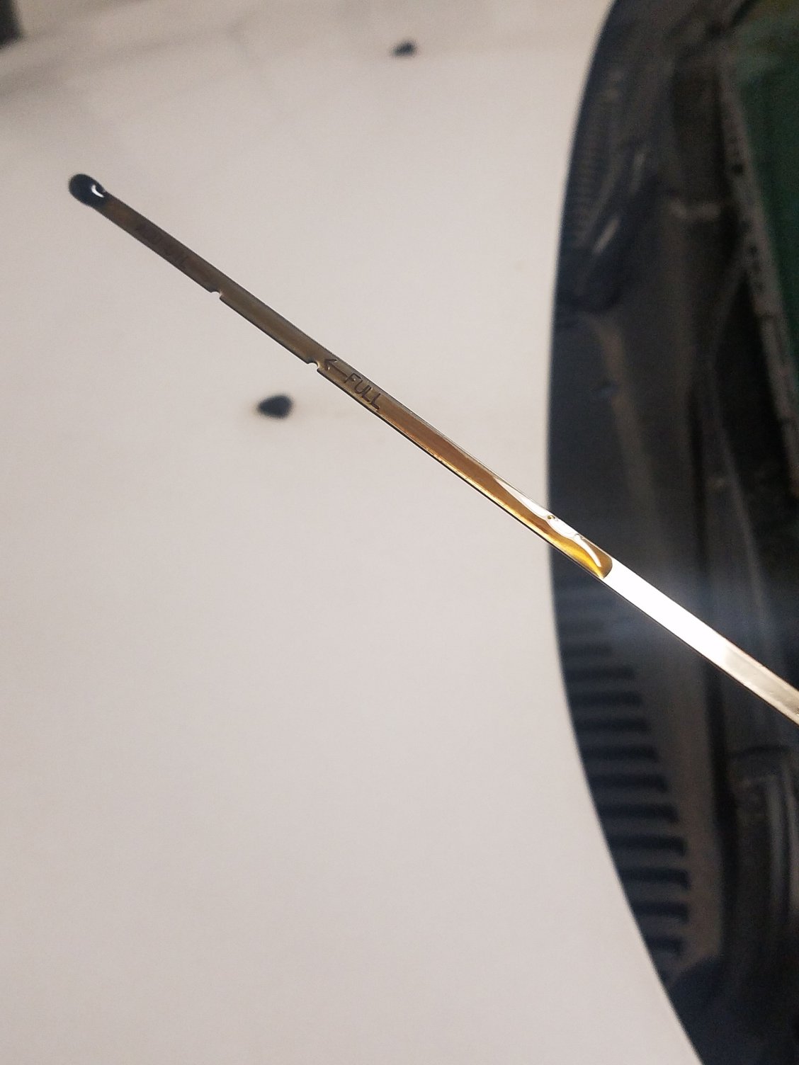

Since you just changed the oil, how about putting a couple miles on the truck and checking the dip stick?
The fresh oil should be able to show if there is any coolant in it by looking at the texture of the oil on the dip stick.
IF someone put dye in the oil to check for leaks, there still may be a little bit in the fresh oil even after a change.

here you go Over Rover and the oil on the dipstick by the way, is before I changed the oil and I've never really seen yellow gunk under an oil cap that's a little unnerving. But im gunna Yuck
glue this baby together somehow
