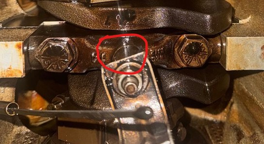

Old Dec 26, 2025 | 08:43 AM
  #24
WaltNYC's Avatar
Joined: Mar 2010
Posts: 2,787
Likes: 628
From: NYC
That thing in your hand looks to be the spacer for the oil pick up tube. Did you remove the oil pick up tube? Did you replace the oring?
