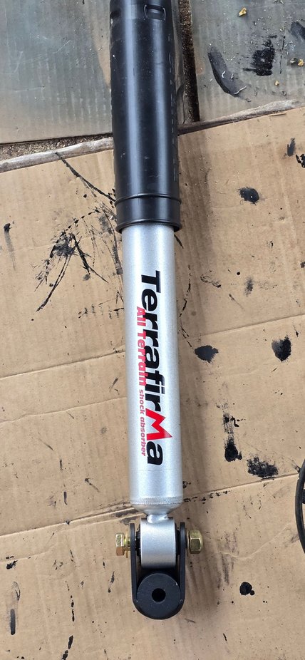

All I did was changed all 4 coil springs, struts, and added 2 inch lift blocks. Terrafirma.

Thanks. Are those coil springs i got sufficient for the 2 inch blocks? Or I need to get better ones for a sag?
also I got these struts. They extended. Should get better ones you mean?
https://a.co/d/egBw2Pb

Those are stock length and functioning shocks and not suitable for anything other than an on road vehicle at stock height.

On suspension lifts you need extended medium duty shocks that will run you about 100 to 200 dollars per shock, 150 will get you decent ones.
