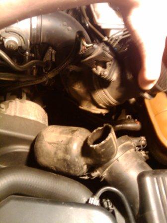

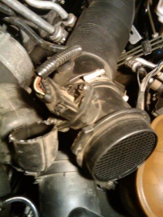

Check it out someone with the same questions i have, just got my new to me disco II already hit walmart for the $ 20 sub fix, doing the oil change, coolant and hopefully trans fluid tonight as suggested but was unaware of the driveshaft thing. That headliners got to go to but thats partly why i got a good price so i cant say anything so bad about it. got 136k on the vehicle and seeing the rocker covers in my near future due to some kind of nasty creeping down the block!
1. good question what is the bulb thing on the bottom of the intake manifold hose behind what i think is the MAF sensor since mines just kind of hanging which i know is v bad since its kind of subverting the point of the air filter.
Can i just tape over this for now?? or will i do lasting damage to the vehicle??
