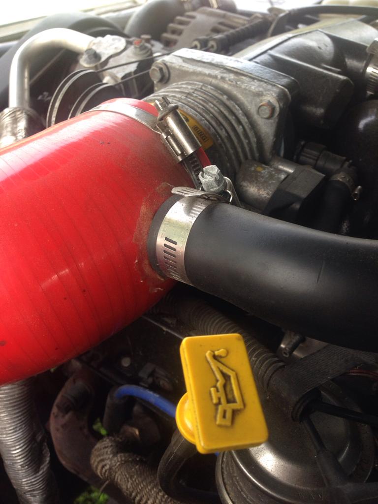

Using this you can see very simply how it is assembled. The only real "custom" part is the extra intake tube right beside the throttle body which you can see here.

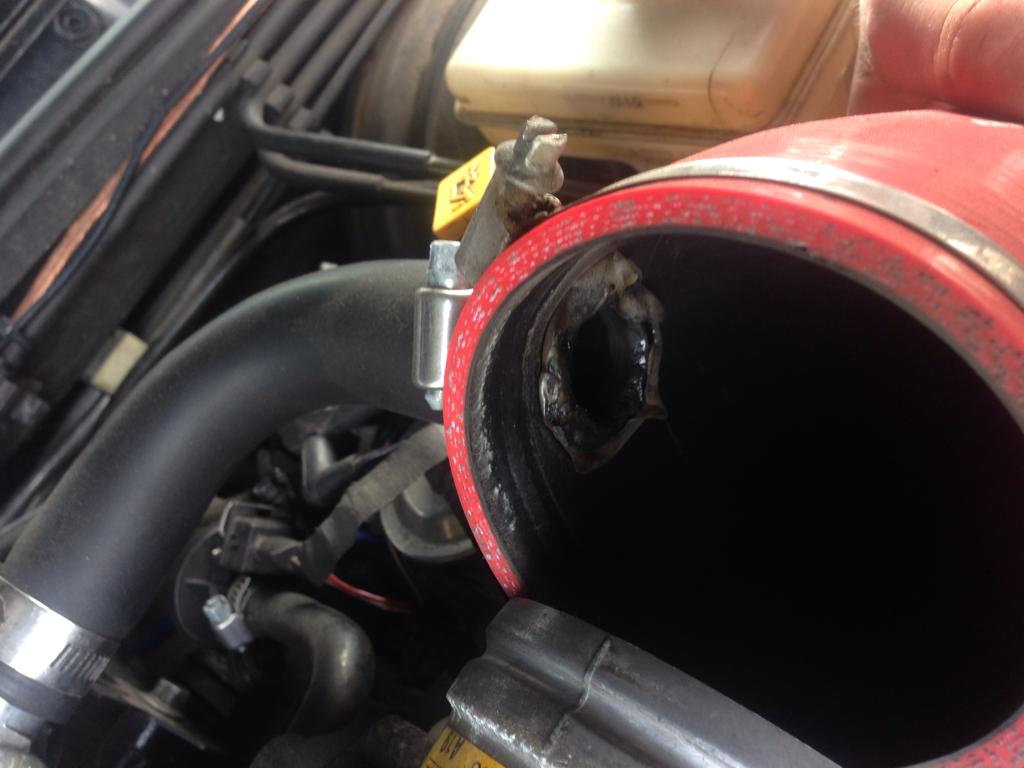

And from the inside here
I just cut the nipple with base off of the factory intake then cut a hole in the Silicon coupling just barely smaller than the nipple. I glued it, but it's not really necessary. As you can see the glue has peeled. I just recommend bracing it from behind when you slide the tube on and clamp it down which will keep it from sliding out.

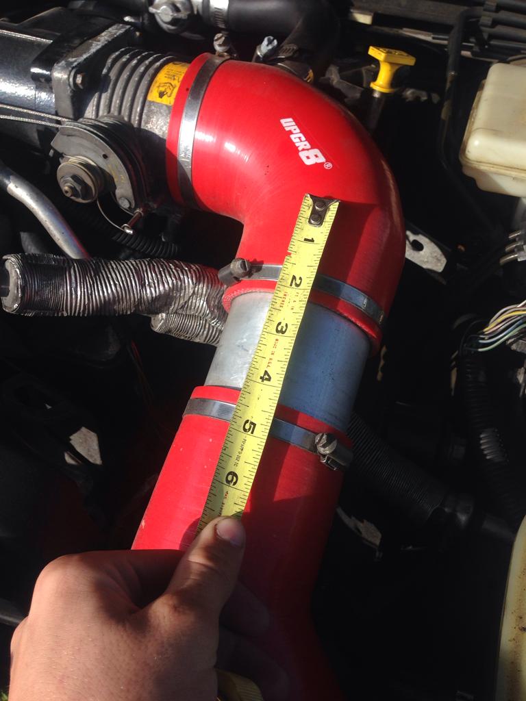

I'll double check the 6 inches real quick.
That's expensive! Jeez! I paid $68.
That AEM actually won't work. The inlet side of the MAF is actually a different diameter than the outlet side and the throttle body. What I did was I just walked in O'Reilly with my MAF and said I needed a K&N that would slip right on, so I'm not actually sure of the diameter.

Yep, 6 inches should be perfect!
