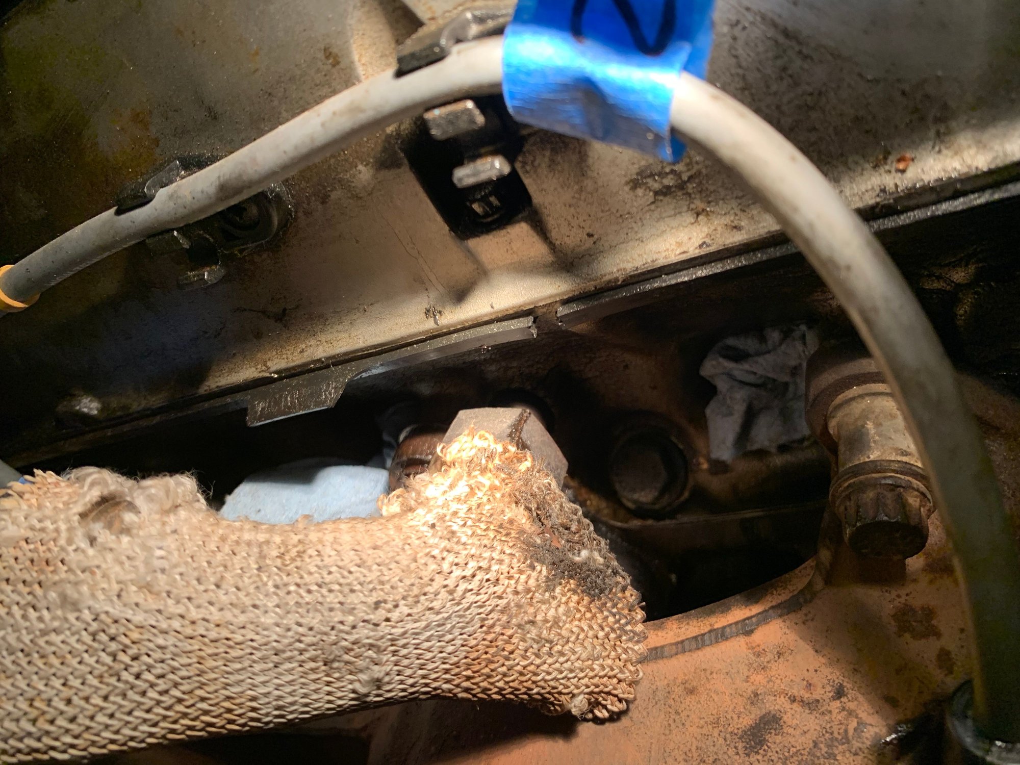

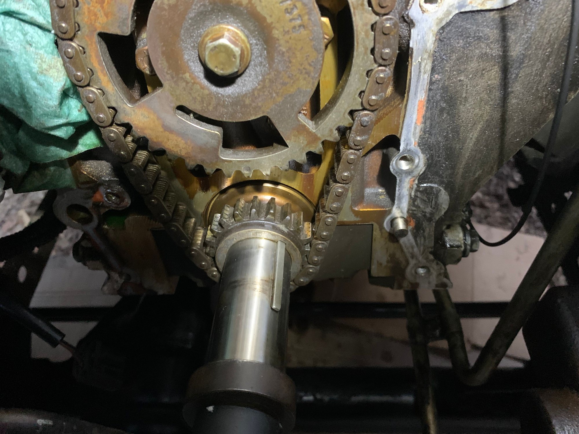

Trying to remove crank and cam bolts without moving chain wheels now that TDC is set. I had loosened the bolts before, but just to be sure I could loosen them. I used the wood block method. I can’t fit the block in now without it dropping out of the engine block or moving from TDC. Any ideas? I’m not sure how this is supposed to be done with the special Land Rover tool or a powerful impact wrench, which I don’t have - although I have one that’ll do light work (3/8” drive 18V makita - tried, didn’t work on the crank, maybe the cam though). Very confused. Please help!

You don't need to set TDC before removing them, only before reinstalling the timing set. The gears only go on one way; both the crank and cam are keyed so they cannot be indexed incorrectly. Remove using the wood block. Place the gears back on without the chain to align, then remove the cam gear and reinstall with the chain.

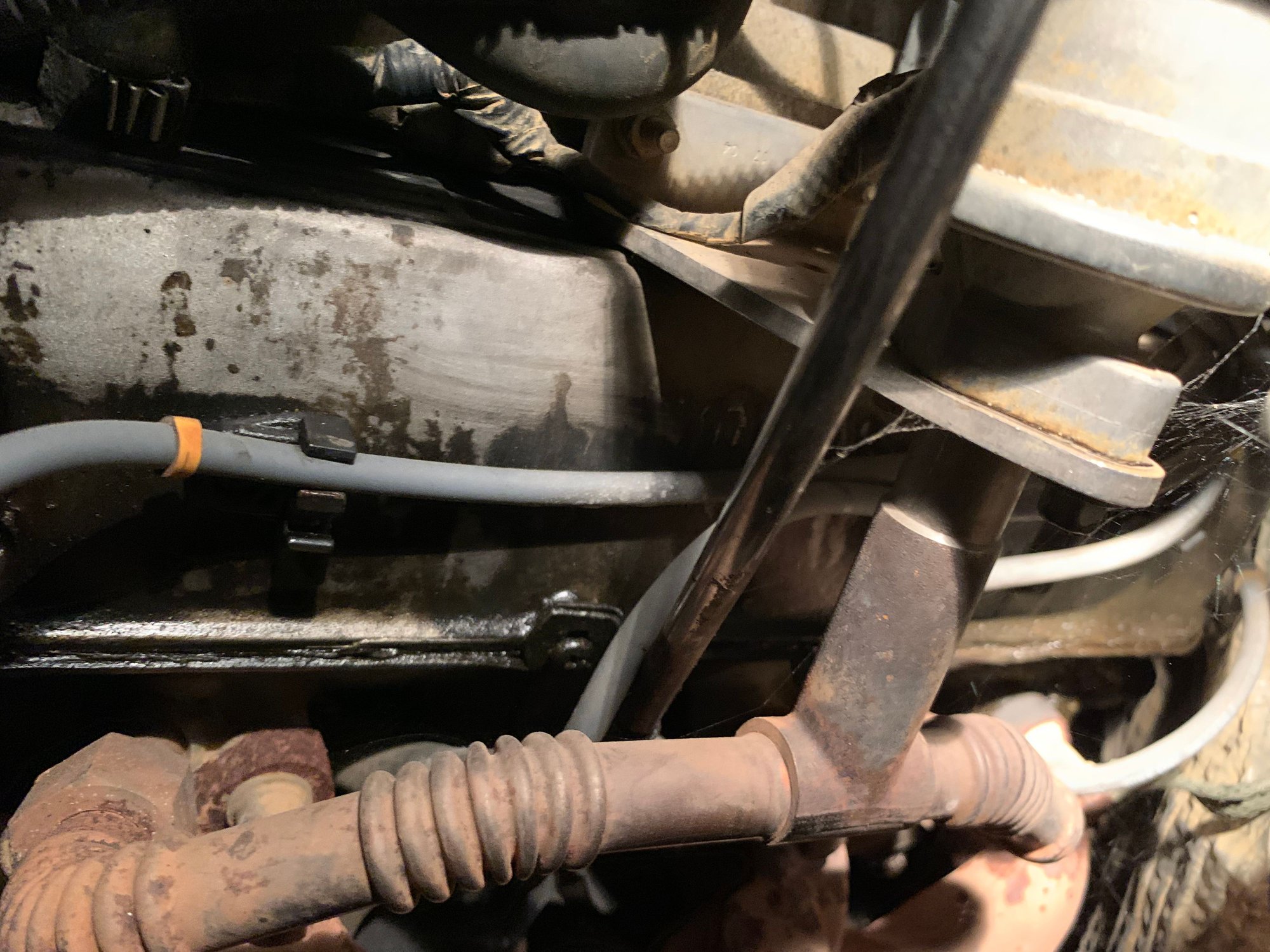

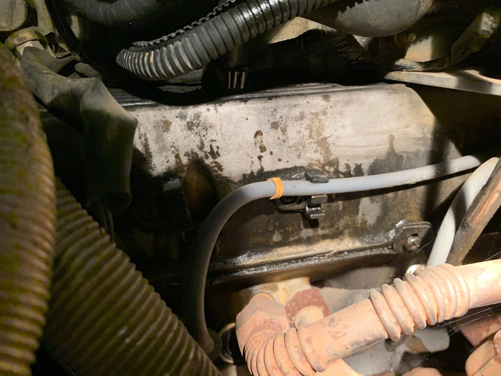

I tried removing the ignition wire and spark plugs without special pliers, just by hand. I started on cylinder 2 and the wire was tough to remove, but it came off, however, when I was unscrewing the plug, it kept feeling loose, then tight, then loose, tight, and so on until the plug broke. I removed the broken piece. I think that’s a symptom of being cross threaded, right?
Wire 4 pulled off easily and the plug unscrewed easily, but it was too difficult to remove the wires for 6 and 8. I tried twisting and pulling, but I think they’ve either got some kind of locking going on, or the plug o ring and boot wire are really stuck since I don’t see that part twisting when I twist the wire.
Any advice to get these plugs out? They’re Bosch double platinum plugs. I don’t know if there’s some locking function that I’m not figuring out? The wires are grey and I think they’re the generic wires from Atlantic British, but I’m not sure. They seem to have little teeth way down the wire, but I think that’s after the bend in the wire, so I don’t think that’s what’s locking the wire and the plug together. Maybe it’s just the boot stuck to the o ring on the plug. Will the special ignition wire pulling pliers make this easy I think I’ll try to get those locally or order them… The wrench sockets and extensions I have seem to be fine without needing a special spark plug extension swivel socket and I’m trying to save money.
I already need one new spark plug since I broke one. Is it likely that pulling and twisting the wire damaged it? I don’t know how fragile they are, but I hope I don’t have to replace the wires to get the vehicle running. I guess I’ll worry about that later and just get the front cover, sump and all the parts back on.
