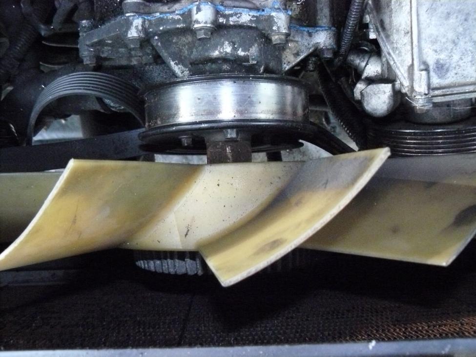

You could also use a $10 boneyard GMC fan slightly modded.... or a D1 fan or a Rangie fan
