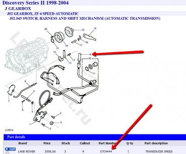

See Attached. Looks like Oreily carries them. Learned something new today. Hope this fixes your issue. From what I can tell it should just pop out.
Import Direct Ignition 13-0342 - Speed Control Sensor | O'Reilly Auto Parts
Land Rover Part # is STC4444.

Old Mar 10, 2014 | 07:41 AM
Redd's Avatar
Joined: Mar 2014
Posts: 15
Thank you, I ordered part just now...$82.00 USD. Orileys offer but can't get it and there is a forgien part store by me has it same price. Orileys says they offer it but have to go to dealer = 5-7 day plus shipping/handling = $117.00!! Really?
After all these post if it matters it is a Disco II series II....donT know if it matters. Because they asked me if was a SD or series II. Will let you guys know out come. Thanks again!

A transducer and a speed sensor are different pieces, the transducer really just relays the speed of the mechanical cable to another cable.

Thank for everyone's help! I did get a speed sensor and this part looks like I need to drop pan to install? Sound right? And just read latest post....#17 ZGPhoto you got me thinking.did I just waste $82? Also if installed if that is it, will speedo just start working again?
