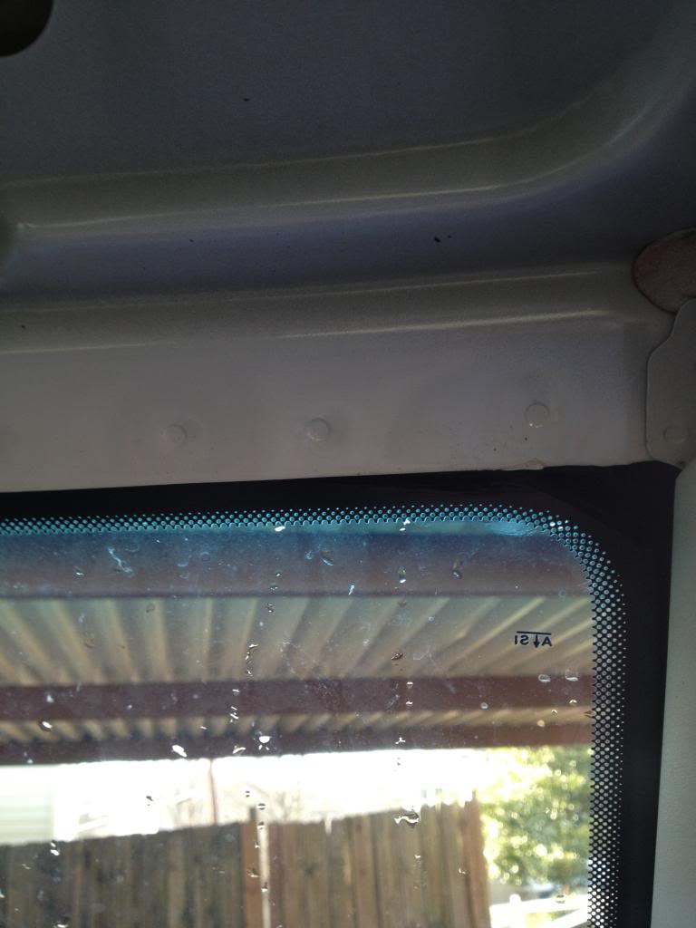

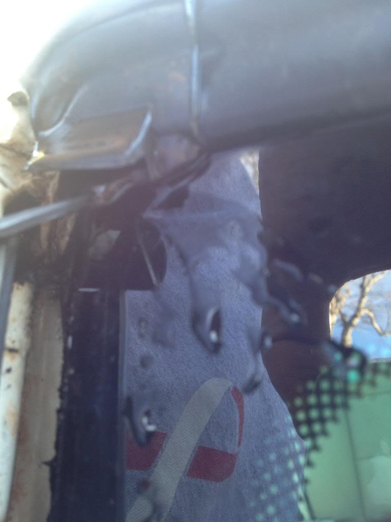

I took off my headliner today to track down a leak that occurs during moderate to heavy rain. It always drips from around the passenger A pillar when sitting still or can move all around the front of the headliner while driving. So, with headliner off I soaked the sunroofs with the hose and they are amazingly leak free although it did start to drip a little by the A pillar. After finishing its drip, I then soaked the outside A pillar and gutter while not wetting the sunroof, and the leak came back. I threw in some pics of where the drip occurs and the outside of the A pillar. If you notice in the last pic, that curved trim piece has a chunk broken off it making a kinda triangle shape. The driver's side is not like this, allowing the water to run onto the windshield. I'm wondering if over time this has caused water to wear out the seal around the windshield in that corner. Anyhow, I guess I will get some sealant tomorrow and seal around that area. Any suggestions on sealant type or technique? Thanks!
You can see the drip here right under that last rivet.

Looks pretty cruddy from the outside

Here's where you can see the triangle piece where a chunk has come off
