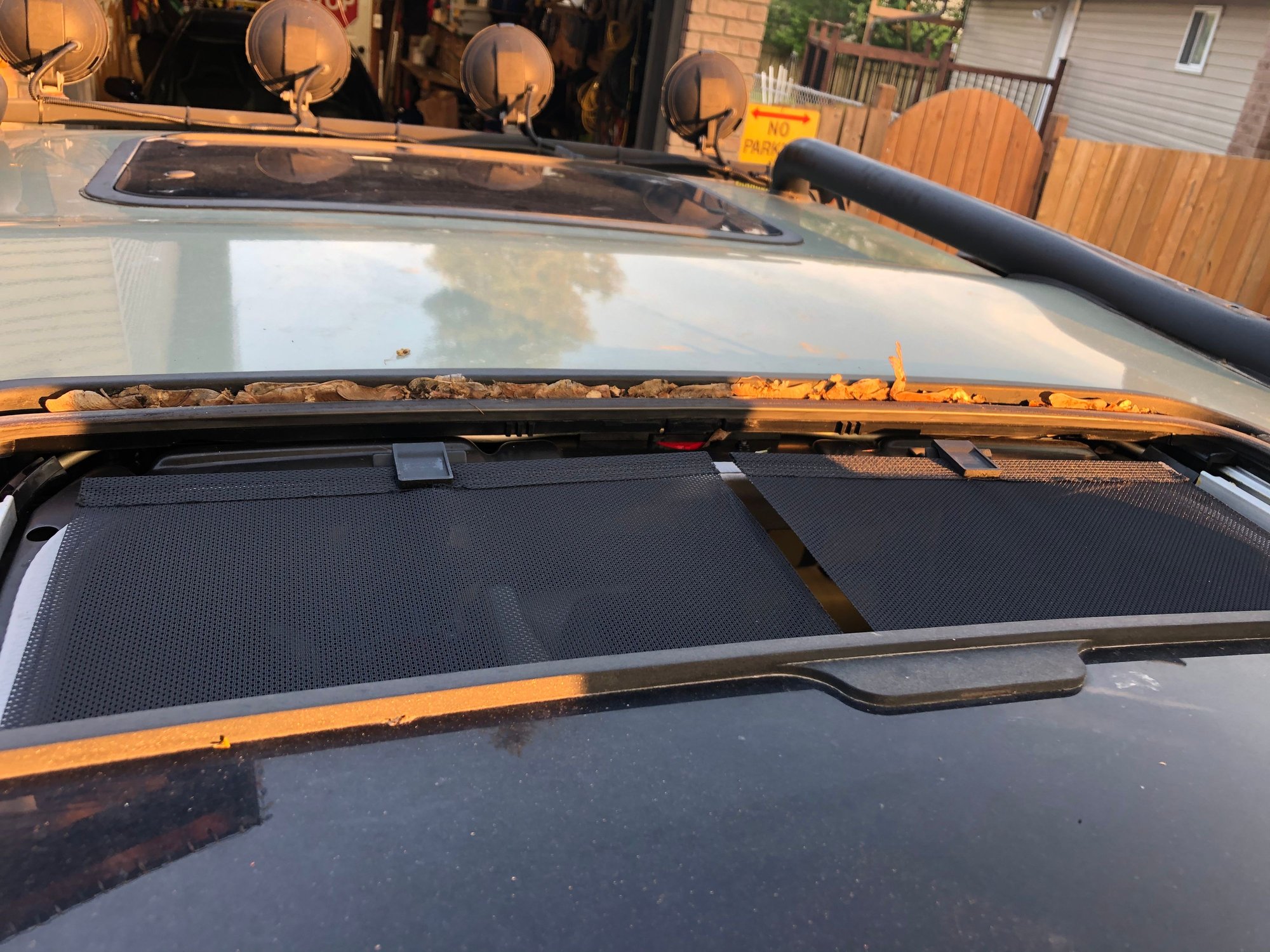

Last summer I spent a good while redoing my 2 sunroofs. Resealed everywhere, new tubes, new frames, etc etc etc.
This winter my rear sunroof was leaking. Again. I was so depressed about taking the headliner out yet again to figure it out. Finally opened the rear sunroof to see an approx 2" piece of stick laying perfectly on the seal between the seal and the glass. It was the reason for my leak. I couldn't see it from above or below with the roof closed ! So it's not always something super annoying.
I park outside in the PNW alot, and the moss covered trees here drop more crap, tiny moss bits than I'd ever thought possible. I now keep a little stiff bristle detailing lug nut brush in my Disco, so whenever I park under a cherry tree (or something else) dropping loads of debris, I simply clamber up on the rock sliders and get the debris out (before opening my sunroofs on a drive). Has helped immensely.
