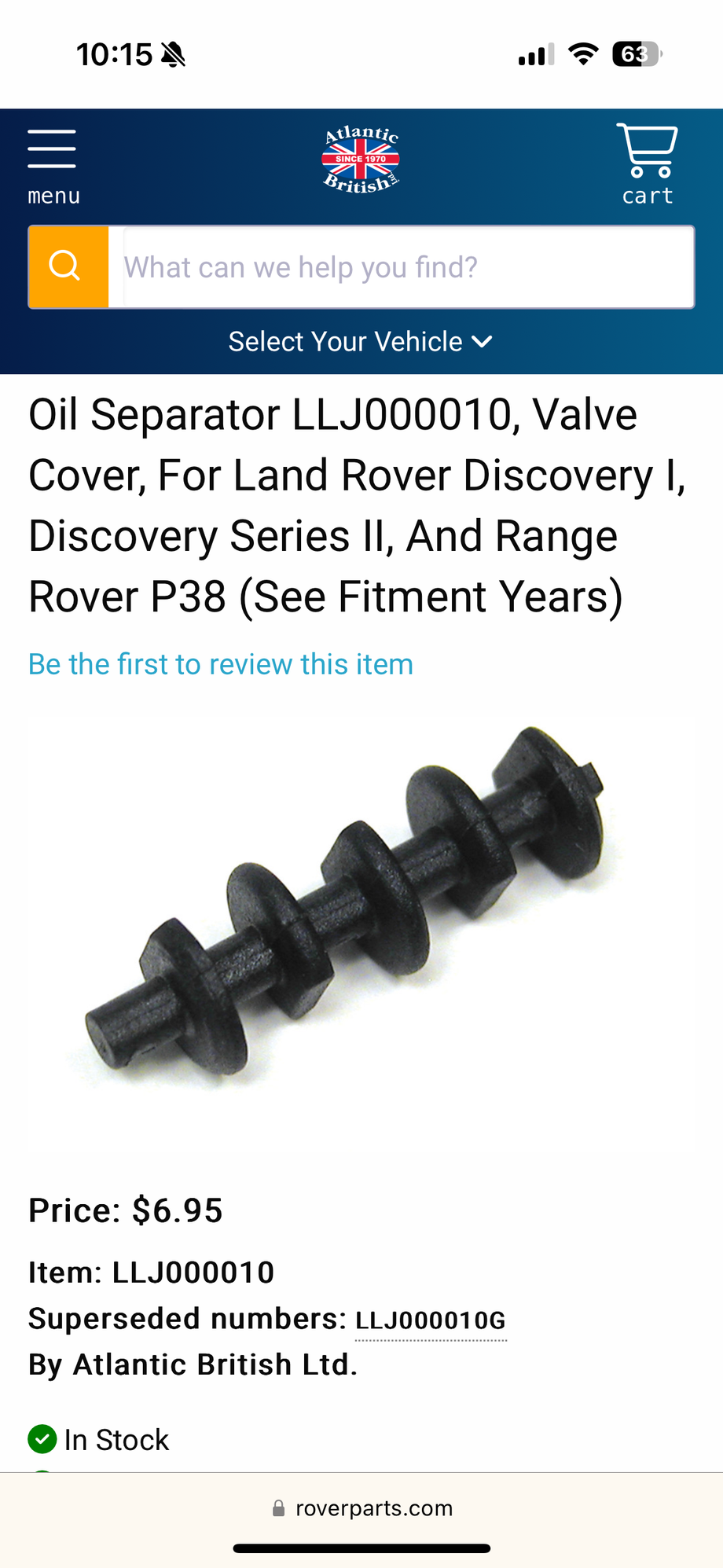

Default Solved
I figured out the surging idle and the IACV code. I will probably start another thread about this because it has to do with another modification I had done earlier.
While trying to solve the surging idle and IVAC code I was reading posts from every LR forum I could find. I found a thread about surging idle and the fix was the oil separator valve which I had REMOVED during my last head gasket install. I removed it after reading a thread about this valve allowing too much pressure to build up and causing valve cover leaks( thats what I understood anyway), I also replaced the plastic connector at the intake that the hose from the valve cover connects to with a brass fitting.
I installed a new oil separator and the surging idle is no longer happening and the IACV code has not returned.
Glad to be able to post a solution. I hope this helps someone else and thrilled it cost less that $10!

Or do the PCV mod.

Yeah that’s the mod I did. If you read my follow-up post I replaced the plastic part at on the intake with the recommended fitting.

@Frank4 Just take it out and clean it every oil change - they can pack with crud up pretty quick
