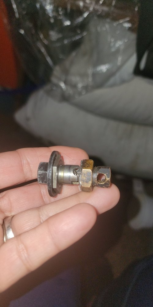

The broken bolt I tried to fix but failed.

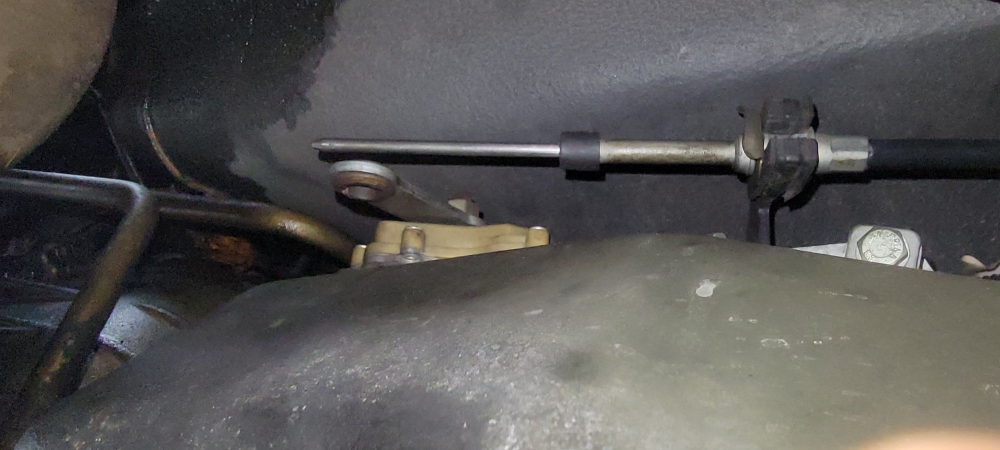

Heres where the bolt was on the shaft that connects to the gear shift

There it is! See where the gear shift is then connected to the cable, at the end of the cable is a stainless steel shaft and on it is where that bolt is that broke off. I took a picture of it and going to upload it now. THANK YOU SO MUCH!
This is the stainless steel shaft it was on and connected to the arm thing next to it.
This is the broken bolt I tried to fix but failed.
