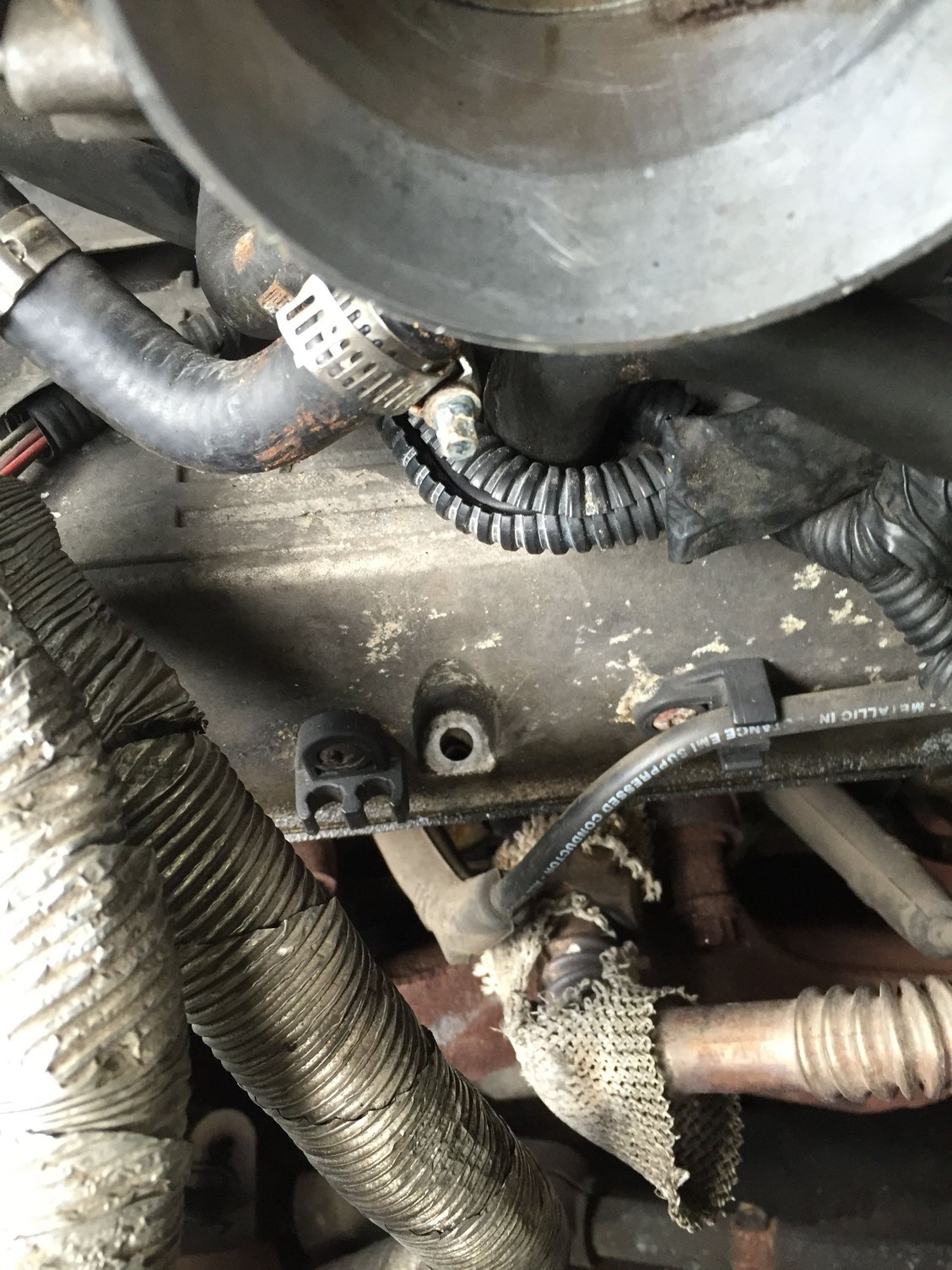

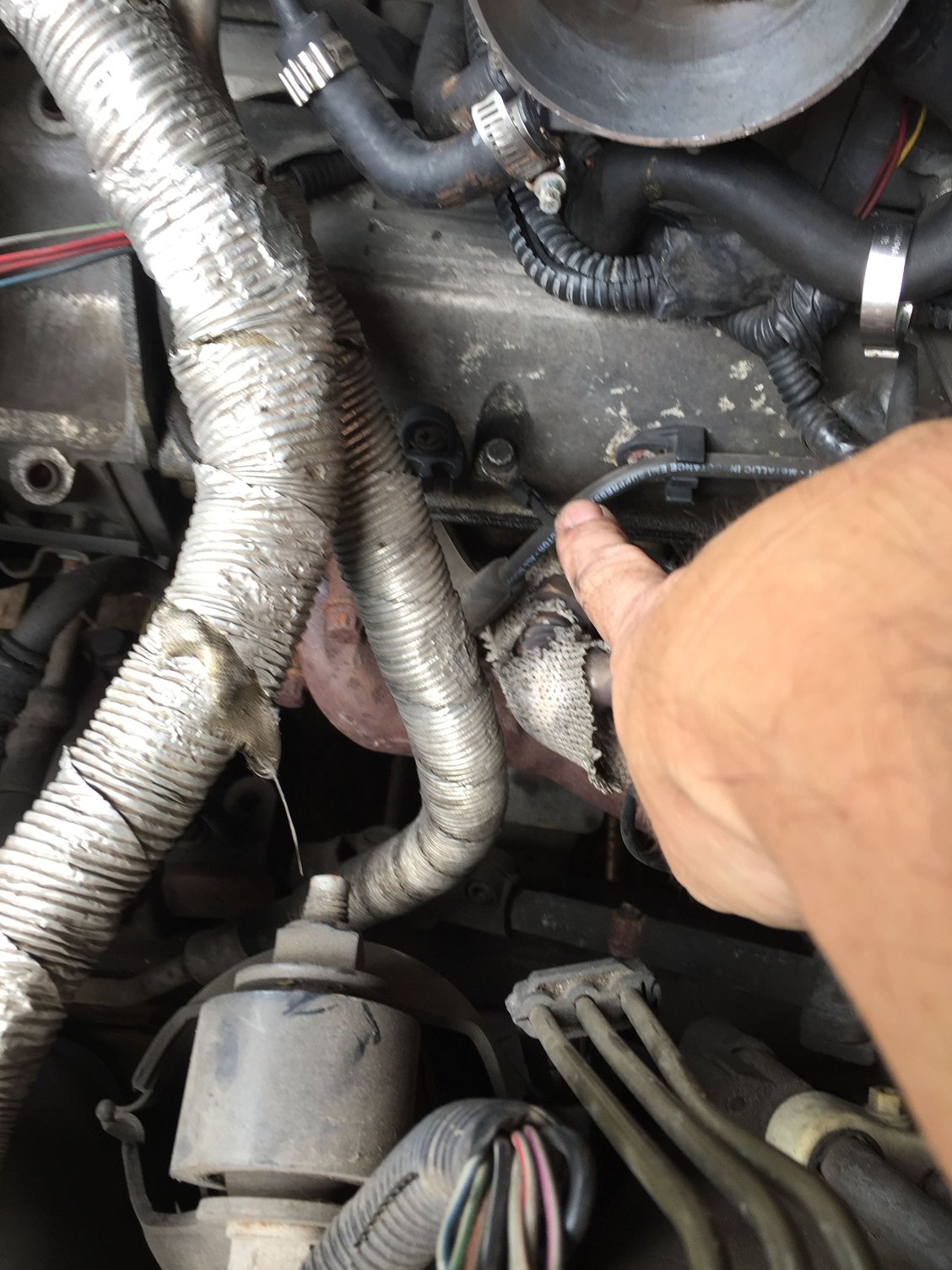

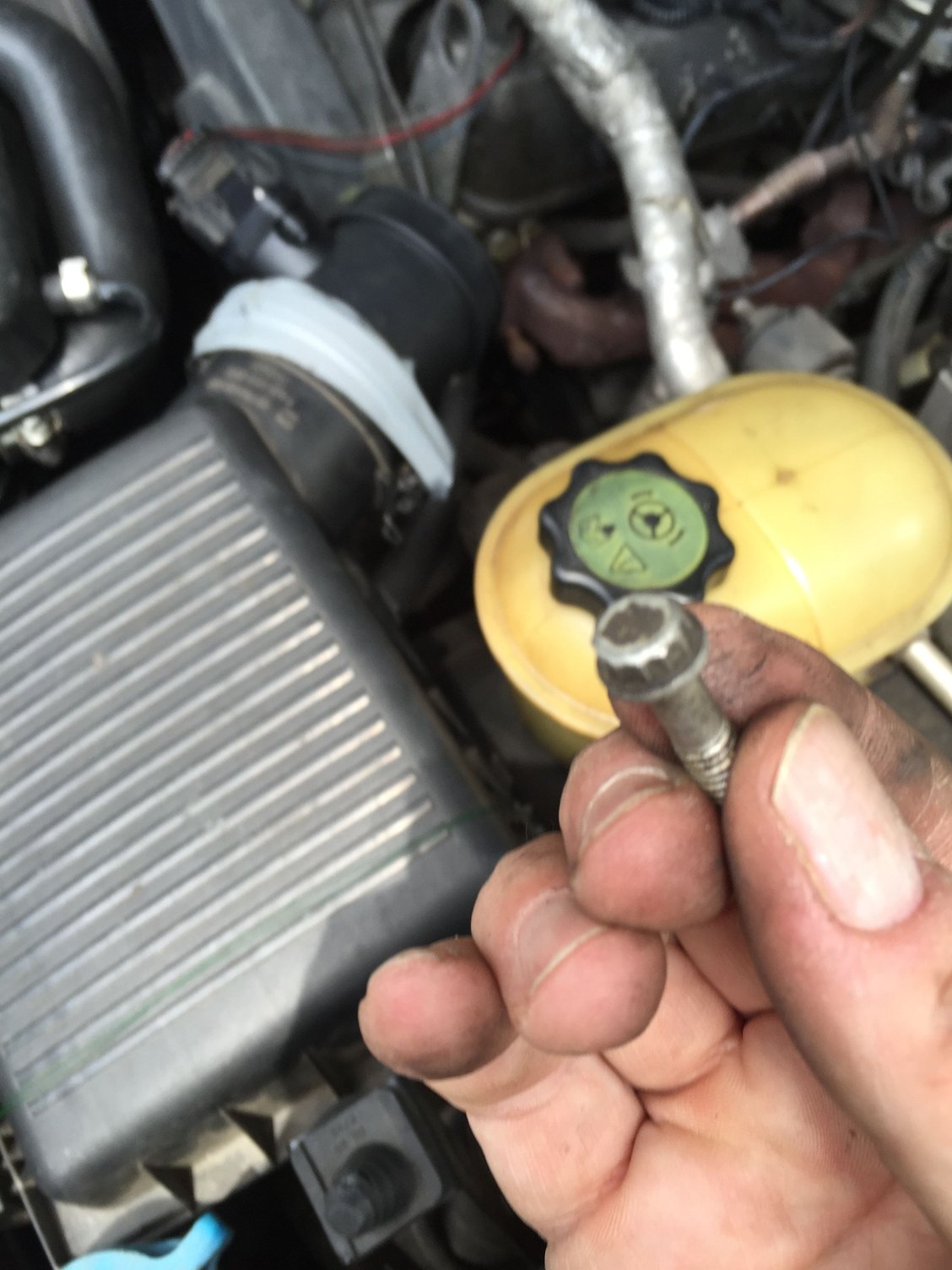

I had a few minutes during lunch today, so I opened the hood to take a look at the grounding wires, and wouldn't you know it, the driver's side was loose and shaking around. I removed it, cleaned the connections with some electical cleaner and re-attached it, the Mariachi band of warning lights has stopped!
Next step is to put the code reader on it and see if I can get some codes that tell me the real problem rather than a bunch of low voltage codes.
Thanks! This saved me a huge amount of diagnosis time.
Here is the grounding wire, just below the air intake on the driver's side.
Hardest part of this was finding the right socket for this crazy bolt. 11/32 was the closest fit, but still not quite tight enough to get it really snug.
Used some electrical cleaner to clean the connection while I was in there.

My ground connections are just as Charlie described. The socket for that valve cover bolt is 1/4 inch drive, 12 point 5/16 inch.
