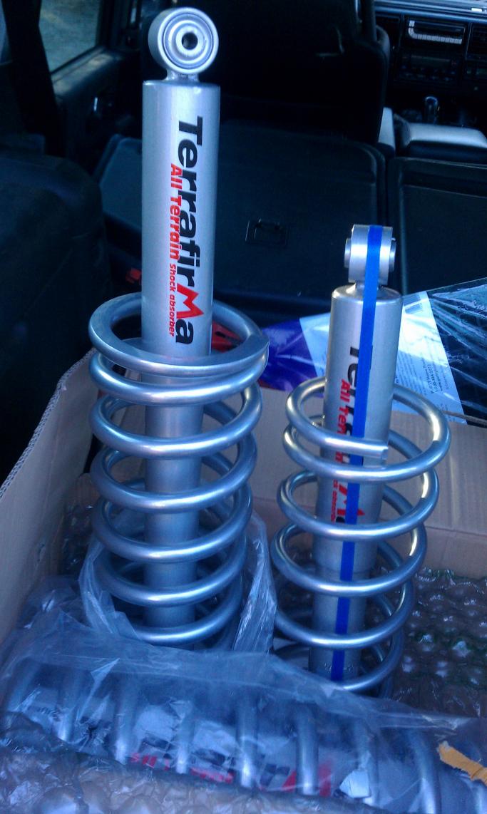

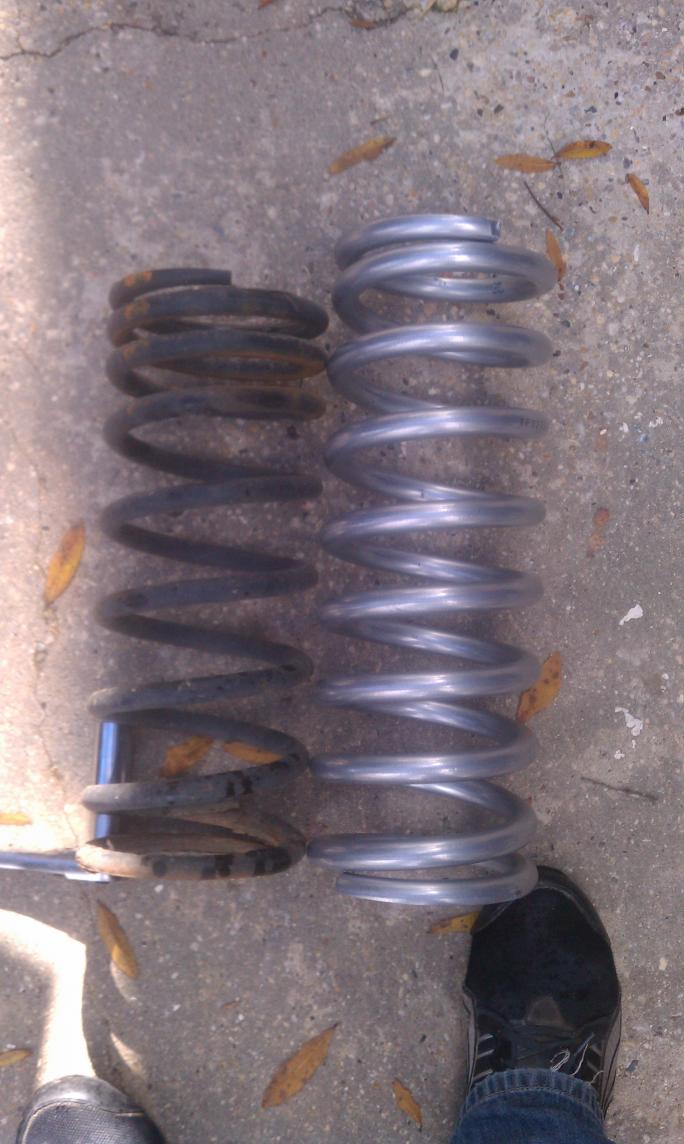

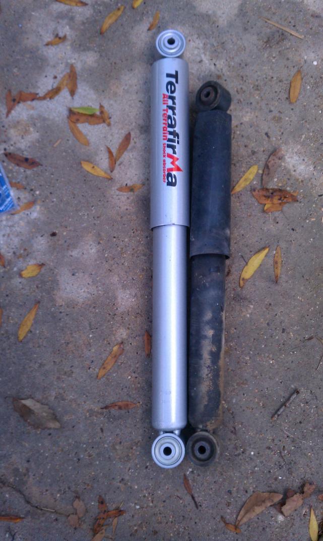

Here are a few Pics I just remembered I had of my +3. As you can see the rear coil and shock are longer and thicker than the factory rears, I did not take pics of the fronts due to time and dirty hands but will later this week. I am adding 1" spacers to my front because it sits an inch lower than my rear. This is the HD set and I did get 3" in the rear (that really sounds good lmao) but a little under 2" in the front. The rears are longer and thicker but the front coils we only a little longer and much thicker but the shock was much longer. I know I dont have to take the fronts out to install the spacer but, its only 4 more bolts and would help give a better reference point on the TF lift. The front damper is also thicker. My ride is a little more harsh but when the rear TR bumber and TF sliders are on Im hoping for a little softer ride do to the weight. Mine had running boards on that weighed 20 lbs each and the TF sliders with tree bars 78 lbs I believe. so Im adding 136 lbs in sliders, the front ARB is 160 lbs and factory was I think 60 lbs so another 100 lbs and the rear TR rear is 90 lbs Im taking a guess that factory rear is around 30 lbs so another 60 lbs added....so 266 lbs added and that is not counting the added weight of the +3 lift which was pretty decent oh and the Blue top battery is 50 lbs and other was 27 lbs. Maybe all in all close to an extra 400 lbs. I have diff guards coming as well so more weight. Sorry for the rant. Will measure again with the spacers in and all the other gear on. Im thinking it will sit even. I did take the wheel trim guards off which gave almost another 1/4-1/2" of wheel clerance. Hope the rant is of some help.

Awesome looking stuff aaron! And great info! But I believe he's only looking to do a 2"lift kit on his rig. A minimal work sort of deal.
