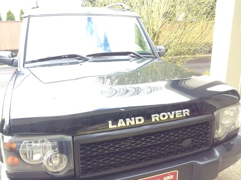

I actually found that my temps dropped when I went to the 03 Range Rover grill mod I did, it has a lot more open space for air to go through, this pic was before I put the land rover logo back on it, hence the random black oval on the drivers side of the grill

My 03-04 Grill mod is basically turning it into a RRS grill with thousands of little holes. The air passing thru it is better vs solid slates found in the 99-04 grills.
