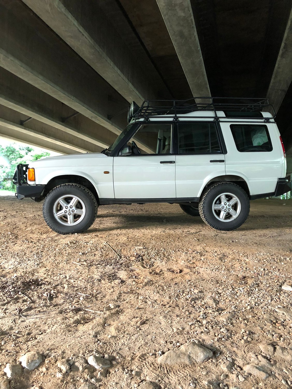

Go 3”. More versatile when it comes to tire and bumper choices. You absolutely do not have to do any adjustments of the panhard bar or anything else, that’s complete misinformation perpetuated by people reposting others opinions.
3”RTE W/ 275/70R18 (33”)

I'm not reposting the opinions of others, or even an opinion. I have a 3" lift. It noticeably shifted my axle to the driver side. My tires (with spacers) are wider than yours. With a wider stance (and pior to bumper and winch, so taller--we have the same bumper) the shift is very obvious. The rest of my lift is on the spring perches so it doesn't affect the right / left orientation of the axle.
Beautiful Rover, BTW. How do the wires go through the roof for lights?

Well I didn’t experience any of those problems. I am still running stock length brake lines.
Thanks for the complement. I’ve tried to keep the accessories as classic and period correct as possible. You don’t have to take your wires through the roof. I ran mine from power under the hood under plastic on the A pillar. You don’t even have to take the plastic part off. Just get the wires started at the bottom of the pillar and use a panel tool to raise the inside edge as you tuck the wire in. Takes 10 seconds a side.

Looks great, any downside to removing the plastic wheel well arches? What roof rack do you have?

I took mine off and the only downside was getting the adhesive off.
